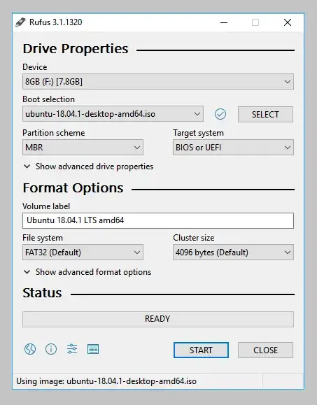

Follow these instructions:
1) Get a 4GB or larger USB.
2) Download Ubuntu Desktop ISO from here.
3) Download Rufus from here.
4) Launch Rufus.
5) Insert your USB stick.
6) Select your USB in the "device" field.
7) Select FreeDOS in the "Boot selection" field.
8) Click the "Select" button right of "Boot selection" and select the ISO file that you downloaded and click open.
9) "Volume label" will be updated. Leave all others as they are and click "START". It should look something like this:

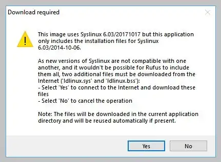

10) If this dialogue box appears, click "Yes". Require additional downloads

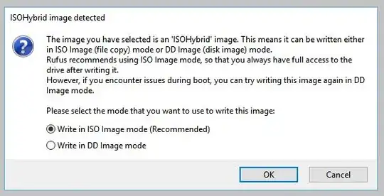

11) Select "Write in ISO Image mode (Recommended)" and click OK. ISOHybrid
