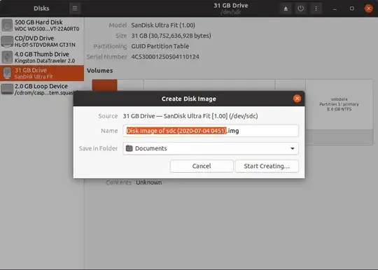

  • Boot Live USB, plug in Source USB.
  • Open Gnome-Disks
  • Select the disk you wish to backup on the left.
  • Select the icon that looks like a stack of pancakes upper right.
  • Click "Create Disk Image" and enter a location where to save the image.
  • Use the pancake icon or use Etcher, Rufus, dd or mkusb when you want to restore or clone the image to another drive.
