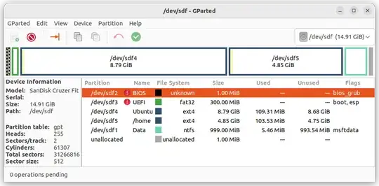

  • Select Device tab and create a GPT partition table on the Target drive.
  • Create a 1GB NTFS or FAT32 partition on the right side. (optional Linux / Windows data partition, See Note 3 at bottom). Size may be increased on larger drives.
  • Create a 1MB partition on the left side, format as unformatted.
  • Create a 300MB FAT32 partition next to the 1MB partition.
  • Create a 9GB ext4 partition next to the 300MB partition.
  • In the remaining space create an ext4 partition, (optional for /home partition on larger USB).
  • Highlight the 1MB partition.
  • Apply All Operations.
  • Flag the 1MB partition as bios_grub.
  • Flag the 300MB partition as boot,esp.

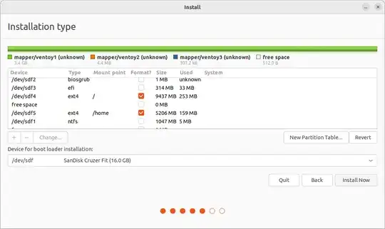

  • At "Installation type" select "Something else", click "Continue".
  • Under Device for boot loader installation select the target drive.
  • Select partition sdx4 and click change, select use as Ext4, select “format this partition”, and Mount point = "/" then OK.
  • If asked to Write previous changes... click Continue.
  • Select partition sdx5 and click change, select use as Ext4, select format this partition, and Mount point = "/home" then OK. (optional).
  • Click Install now.

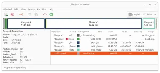

  • Create a 5GB NTFS or FAT32 partition on the right side. (optional Linux / Windows data partition, See Note 3 at bottom). Size may be increased on larger drives.
  • Create a 15GB ext4 partition next to the 300MB partition.

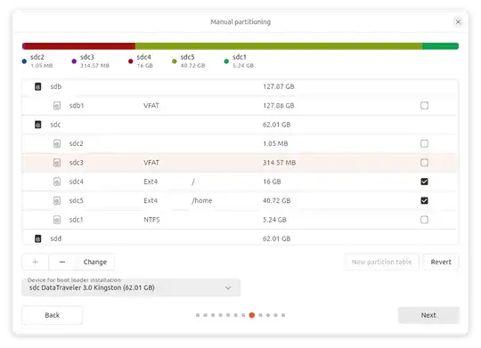

  • At "Installation type" select "Manual installation", click "Next".
  • Under Device for boot loader installation select the target drive sdx.
