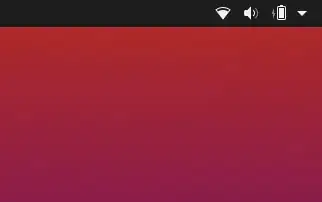

What my screen shows:

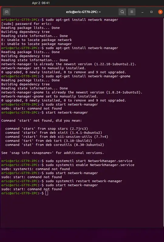

So I tried to follow the manual steps to install network manager:
Followed steps to manually install network manger on USB Sudo apt-get install network-manager Sudo apt-get install network-manager-gnome Try to run sudo start network-manager and get error Sudo:start: command not found Tried restarting network manager with Sudo systemctl restart network-manager Seems to work as it produces no error Still cant start network manager
What am I missing, please help
