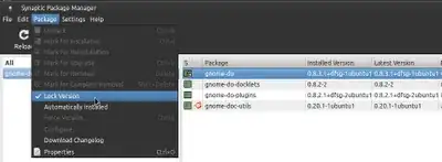

Locking with Synaptic Package Manager
Go to Synaptic Package Manager (System > Administration > Synaptic Package Manager).
Click the search button and type the package name.
When you find the package, select it and go to the Package menu and select Lock Version.
Synaptic menu
That package will now not show in the update manager and will not be updated.

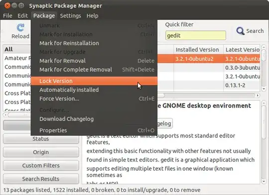

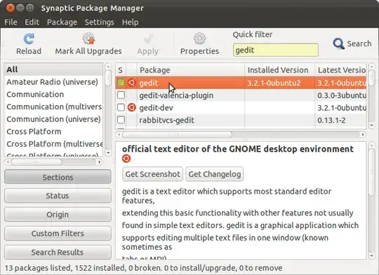

Install synaptic using sudo apt-get install synaptic.
Run using gksudo synaptic and on the search box locate the package you want to lock, ie: gedit
From the package menu select Lock version:
And that is all, the version currently installed at the time of the lock will stay installed even during upgrades.

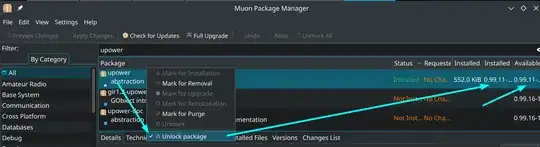

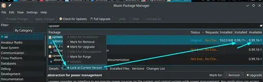

Just because it was not mentioned here, the KDE tool Muon has an option similar to Synaptic's:
