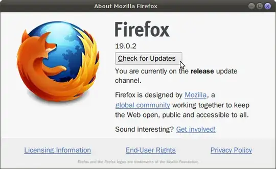

To avoid a 'portable' version being updated, avoid going to 'Help/About Firefox', or the browser will download latest version and will update on restart. Before that, go to 'Edit/Preferences/Advanced/Update' and uncheck 'Automatically install updates' (check the other options instead).
Now, going to 'Help/About Firefox', it will not update automatically, just display 'Check for Updates'.
So, you may update any time the current package. In order to use older versions, just get the needed package and unpack following the steps above.
