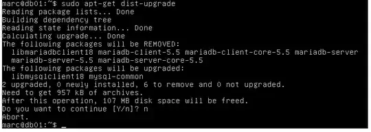

A similar question was asked at Partial upgrade - why remove MariaDB?. The answer to that question basically was stating that dist-upgrade is the issue. This question is asking if there is some workaround (or fix).
Sometimes it is necessary to do a dist-upgrade and not just an upgrade.
Can we change something in our sources.list (or elsewhere) to tell Ubuntu to NOT remove MariaDB?
removing maria db on dist-upgrade

marc@db01:~$ sudo apt-get dist-upgrade -o Debug::pkgProblemResolver=true -o Debug::pkgProblemResolver::ShowScores=true

The following packages will be REMOVED:
  libmariadbclient18 mariadb-client-5.5 mariadb-client-core-5.5 mariadb-server
  mariadb-server-5.5 mariadb-server-core-5.5
The following packages will be upgraded:
  libmysqlclient18 mysql-common
2 upgraded, 0 newly installed, 6 to remove and 0 not upgraded.
Need to get 957 kB of archives.
After this operation, 107 MB disk space will be freed.
Do you want to continue [Y/n]? n
Abort.
marc@db01:~$

MariaDB cover this in their article on installing deb packages, best way to fix it is by pinning the MariaDB repo. Which you can do by following these instructions: https://mariadb.com/kb/en/installing-mariadb-deb-files/#pinning-the-mariadb-repository (if you scroll up they also explain why it happens)
Broken mysql-common:amd64 Breaks on mysql-client-5.1 [ amd64 ]  ( none )
  Conflicts//Breaks against version 10.0.7+maria-1~precise for mariadb-client-10.0 but that is not InstVer, ignoring
  Considering mariadb-client-5.5:amd64 2 as a solution to mysql-common:amd64 8
  Added mariadb-client-5.5:amd64 to the remove list
As can be seen MariaDB breaks if you try to upgrade mysql. You should only rely on sudo apt-get upgrade for the time being to prevent MariaDB removal.
