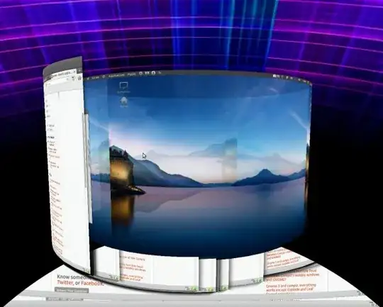

Sometimes my desktop cube/cylinder appears like this :

Unless your Compiz package is really buggy and you are desperate to upgrade it, I would suggest you hold your horses and wait until the fixes made in Compiz during Quantal development is backported to Precise. As you probably might have noted, the fix for your bug has been milestoned to Compiz Core 0.9.7.10 "SRU-1" and would probably land before Precise 12.04.2 point release.
