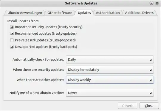

I don't think there's a way to prevent the update notification for particular packages easily, but it's possible to define different notification intervals for security and other updates in software-properties-gtk:
software-properties "updates" screenshot
Since (browser) codec updates are often non-critical, you should be able to delay the notification about them, so that they're less of a nuisance.
