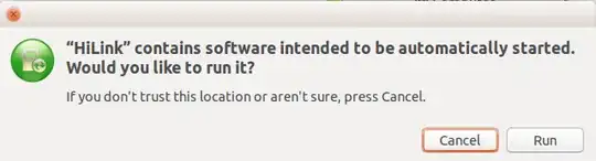

The newest solution I found is to download three packages libnl-3-200 libnl-genl-3-200 libnl-route-3-200 I downloaded them, manually. Then I go to the new folder where those packages located and run sudo dpkg -i lib*.deb and then reboot the system and after that I saw following pop-up message: enter image description here

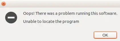

When I saw that message after reboot, I was sure that the solution solved my issue, but it didn't. After I click "Run" next pop-up message popped and crushed my soul instantly: enter image description here
And once again I have no idea how I could make this work. Please let me know if I can provide more information or something. Thank you!
