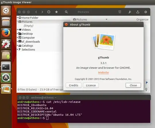

And now the older version will not be upgraded with your next system update! A screenshot on my own system with the older version in place:
GThumb screenshot
