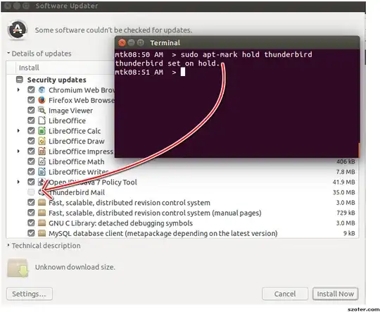

But, I would like to disable/prevent update of a lot of packages, how can I do this efficiently?
The above given method works( as shown in image below), but it's hard to find the names of packages that exactly apt-mark understands. See the screenshot below, I need to disable or put on hold all of these except a few.
The software updater pops up many times (I know i can skip it always), but I am on low bandwidth and can't update each and every package. And I hardly use them, e.g. Thunderbird, simple-scan, music player.
It would be very good, if this software-updater had a option to disable update of a package by just right-clicking or some other way.
apt-mark hold demo image
