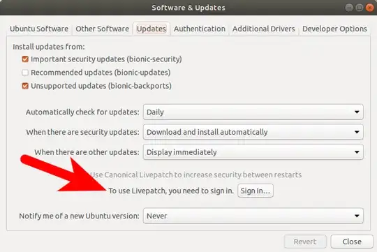

Have you considered installing Livepatch?
You can set this up from within Software and Updates and select the Updates tab.
Whilst Livepatch uses snap as a base, it is primarily intended for use in a server environment and there are definite benefits in making use of this facility.
Further information here.
