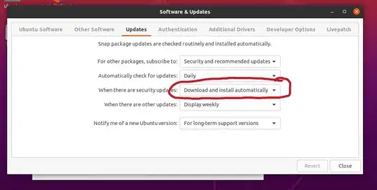

Replace the snap version of firefox with the apt version. It would only update when you update the rest of the packages.
(For Ubuntu 22.04 and above, see this answer to install the pure apt version of Firefox.)
sudo snap remove firefox
sudo apt install firefox
Make sure to turn off automatic updates in the Software & Updates settings.
automatic update
However, make sure to manually apply updates in a regular basis.

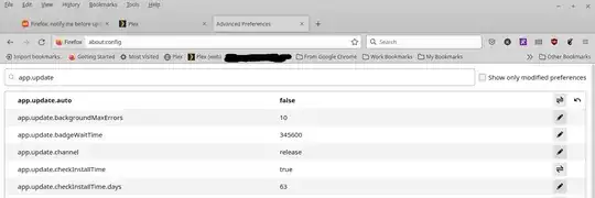

NOTE: This answer is for when you install Firefox directly from Mozilla and not from the repos (snap/apt-get).
If you go to about:config in the address bar and then state that you will be careful, you can set some update settings that should help you.
In the search box after going to about:config type in app.update and set the one for app.update.auto to false, then lower set the app.update.notifyduringdownload to true so that you know when it is going to update.
Hope this helps!

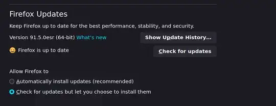

There is a check box in Settings - General Tab to tell Firefox to stop auto update See this:
Image of Firefox settings user interface
Update:

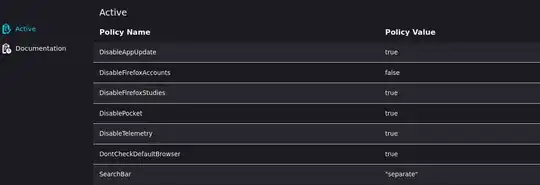

The answer by @Terrance defines another way of disabling update by modifying config variables. There is still another way of defining config variable to enable/stop app update or other things: by defining enterprise policies. The steps are outlined below.
  1. Open Firefox and type about:policies in the address bar. Press the enter key.
  2. A window will open which will list policies already defined.
  3. Click the "Documentation" Tab on the left and you will see a long list of config variable you can define as policy in Firefox.
  4. Close Firefox and create a folder distribution under Firefox directory.
  5. Create a file policies.json inside the 'distribution' folder just created. Refer Documentation tab for name of variables as in step 3.
  6. Edit the file policies.json and specify config variables like this.
 "policies": {
   "DisableAppUpdate": true,
   "DisableFirefoxAccounts": false,
   "DisableFirefoxStudies": true,
   "DisablePocket": true,
   "DisableTelemetry": true,
   "DontCheckDefaultBrowser": true,
   "SearchBar": "separate"
  1. Save the file and restart firefox.
  2. Check the active policies by following step 1.
You should see something like this.
image of Firefox policies user interface

Running Firefox 64bit ver.108, and for quite awhile the setings for auto update has been 'missing'. If you want to still get updates, just not automatically (asks you instead of just interrupting and forcing update at inopportune times...), then try this:
The way I was able to 'disable' the auto firefox update (still downloads, just doesn't interrupt you and install while you sit there helpless) was: open settings - type 'about:config' then type 'app.update.auto' and change the setting to 'false' (see below from documentation)
AppAutoUpdate
Enable or disable automatic application update.
If set to true, application updates are installed without user approval within Firefox. The operating system might still require approval.
If set to false, application updates are downloaded but the user can choose when to install the update.
If you have disabled updates via DisableAppUpdate, this policy has no effect. Compatibility: Firefox 75, Firefox ESR 68.7 CCK2 Equivalent: N/A Preferences Affected: app.update.auto
So, also don't forget to type 'DisableAppUpdate' and change it to 'false' also!
MEANWHILE - be careful when using this 'about:config' as it can really mess things up if you are not VERY, VERY careful!!!
