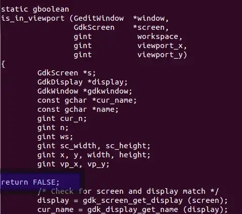

make the change
Open gedit-app.c
gedit gedit/gedit-app.c
add return FALSE; as shown and save.
What this does is to always exit the routine saying "i'm not running in a viewport and therefore always open a new instance"
If you use return TRUE; this will always open in an existing instance of gedit in a new tab...

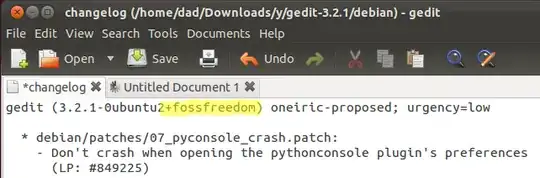

give it a unique package name
OK, we need to give the package a unique name to prevent repository updates from overwriting your changed package
gedit debian/changelog
now append +yourname to the top line version and save the file i.e.
Note - to be absolutely sure - after installing the modified package below, lock the version as per the linked question below.
