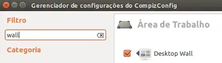

I have the same problem with the Ctrl+Alt+Arrows for workspace-switching hotkeys. Using CompizConfig, make sure that Desktop Wall is enable.
