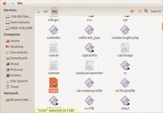

  • Click on "File System" on the left sidebar, and navigate to /usr/bin. Scroll down to CCSM and double-click to run it:

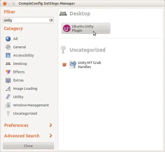

  • Type unity in the Filter box and click on the Unity Plugin:

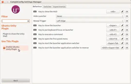

  • Just check the "Enable..." box on the bottom left and you should have your normal 3D environment back:
