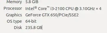

My computer detail:
My graphic driver is : Nvidia 352.55.

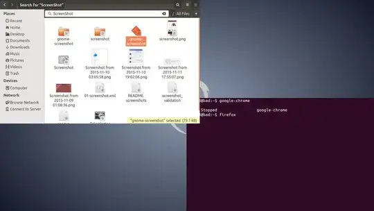

My system becomes like: enter image description here Can't open Dash, Launcher, Shortcut like Alt + Ctrl + T .
Lucky i have Folder at my desktop so i can open via Mouse click.
After fix Ubuntu lost Dash, Launcher, Shortcut Browsers still crashing Browsers still crashing :D
~$ google-chrome
Inconsistency detected by ld.so: ../sysdeps/x86_64/dl-machine.h: 492: elf_machine_rela_relative: Assertion `((reloc->r_info) & 0xffffffff) == 8' failed!
~$ firefox
Segmentation fault (core dumped)
