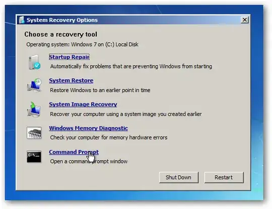

  1. Grab a Windows recovery media or installation CD. You should see this on a recovery media and if you have a Installation CD choose the Repair Your Computer option. enter image description here
  2. Open the Command Prompt, then type bootrec /fixmbr into the Command Prompt. enter image description here
