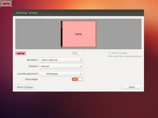

After updating my system today, Ubuntu's doesn't display correctly. The desktop was working properly before, but now it looks like this:
I had to use the terminal to run Synaptic package manager, so I could view the update history, which is as follows:
Commit Log for Wed Nov  7 11:50:36 2012
Upgraded the following packages:
linux-image-generic (3.5.0.17.19) to 3.5.0.18.21
Installed the following packages:
linux-image-3.5.0-18-generic (3.5.0-18.29)
linux-image-extra-3.5.0-18-generic (3.5.0-18.29)
Prior to this issue, the last active driver was nvidia-current-updates, version 304.51. I tried using the nvidia-current driver, version 304.51.really.304.43 instead, but the problem persists.
I tried running nvidia-settings from terminal, so I could try configuring something, but the application informs that the Nvidia driver is not being used.
As the x-swat repository has nothing for Quantal, I desperately used the unstable x-edgers repository and upgraded, but to no avail; so I purged it.
The display should normally be full HD, but the only available resolutions now are 1024x768(4:3) and 800x600(4:3).
The system is a Dell XPS-L702X, with NVIDIA GeForce GT 555M graphics, and a 17" screen.
How can I fix this problem?
Update: I tried using the Nouveau third-party driver and this fixes the issue. However, if you have any idea how to get the Nvidia drivers working properly with the latest kernel, please share; as I've noticed some videos playing very slowly on the system, though I'm not sure exactly why.
