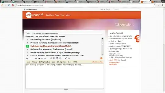

Good evening Everyone, I am having problems recovering my desktop.
Before it came to this desktop without the taskbar at the top, and the sidebar. Also the title bar for applications are gone.

My desktop right now
