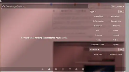

All Applications Disappear in the Dash
I can search all other files without an issue, but when I attempt to search for Applications, I'm not able to do so.
I'm not sure where to go with troubleshooting this - I've ensured that unity-lens-applications is installed, along with unity-scope-master.
Is there anything else I can do to fix this? I'd honestly prefer not to have to launch all my applications from a Terminal.
On a newly-created user account, applications do appear. However, I'd like to get this fixed on my login.

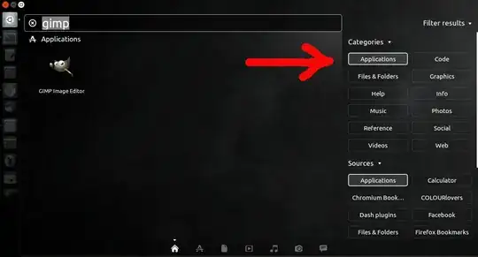

Notice that there is no Applications under the Types or Categories in your case (see attched picture for contrast). I had the same problem after upgrading from 14.04 LTS to 16.04 LTS. The solution worked for me is
Dash (from Unity) does not showing Applications
I copy the answer here:
sudo apt-get purge unity-lens-applications
sudo apt-get install unity-lens-applications
then log off & login.
