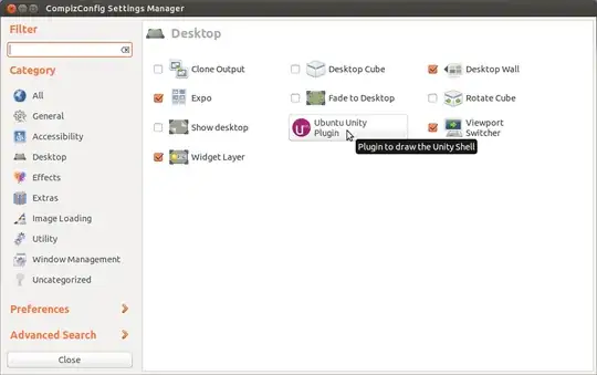

I can't understand what reasons do you have to do this, but let's do it.
First move any files that you have in ~/Desktop wherever else do you want using the following command from terminal:
mv ~/Desktop/* /path/to/another/directory

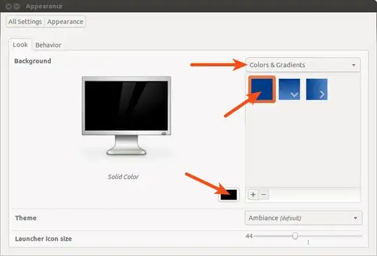

Second, make your desktop background black:
appearance

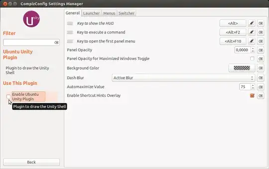

Third, run the compizconfig-settings-manager Install compizconfig-settings-manager package and disable the Ubuntu Unity Plugin:
ccsm
ccsm - unity plugin
