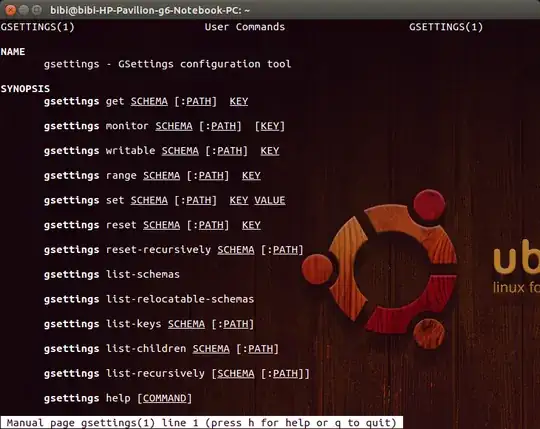

then to re-enable it you have to simply run
 gsettings reset com.canonical.Unity.Lenses disabled-scopes
I got this info from
man gsettings
