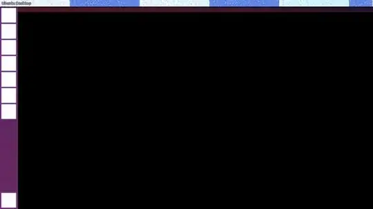

I am using Ubuntu 14.04 64bit and Nvidia driver on my PC. After updating Ubuntu, Nvidia crashes and this is my new Ubuntu desktop:
When I enter to tty and run DISPLAY=:0 compiz --replace I see blank screen with mouse pointer and only can right click on the desktop and access right click options but no close, maximize, minimize buttons or shadows, only can move windows.
After that, I managed to switch to Nouveau and see no problem, Also Nvidia works with ubuntu-gnome desktop!

I had the similar problem two months ago with ubuntu 14.04 after an update. My PC is running a nvidia geforce 7300 gs. Not exactly the same card as yours, but maybe the solution I applied will work for you as well. I uninstalled nvidia-304 driver and installed the nvidia-173. This is not a perfect solution, because I still encountered some minor issues, namely while switching to another account, and sometimes I need to login twice to enter my session.
Before login, go to a terminal (CTRL-ALT-F1), login and execute the following commands:
sudo apt-get remove nvidia-304
sudo apt-get install nvidia-173
