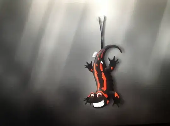

Just restarted my computer and this happens, tried switching desktop managers and the same thing. Help?
