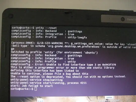

UPDATE: As suggested by dadexix86, I tried to reset Unity with the terminal, without success. In the picture is the error message I got (sorry for the potato quality, but the screen capture isn't working, either) enter image description here
