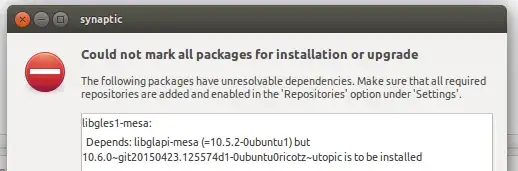

Trying to install libgles via Syanptic gives
Which when checking in Syanptic is clear:

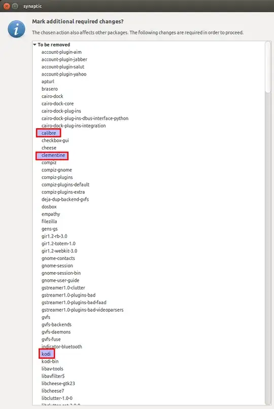

Trying to force a specific version back down to 10.5.2 seems to indicate it's going to install a lot of my things which I have configured nicely:
Obviously I don't want to do this, but I would like to be able to use this PC again.

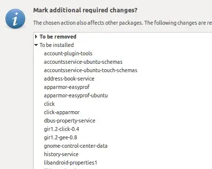

They don't appear in the to be installed list:

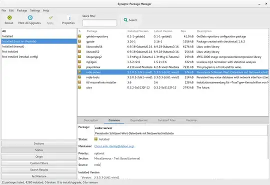

Currently we have only Synaptic Package Manager, therefore use it:

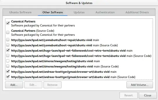

  • Disable unnecessary PPAs and other repositories. You can re-add them later.
    Use Reload
  • All packages in the category Installed (local or obsolete) should be removed or downgraded
    First try a downgrade. If that's not possible, remove the package. Do this step by step, not all at once. After each removal, check the category Installed (auto removable) and remove the packages also. Be in mind, packages can be re-installed but you should not remove the kernel ;)
    From time to time it's necessary to restart Synaptic. But this assertion comes from my experience and does not have to be true.
