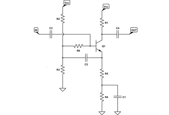

Not Entirely Improbable Example
Here's an example of a less readable CE amplifier stage. It's a little more of a wiring diagram than a schematic. See if you can manage to recognize that this is a relatively standard, bootstrapped single BJT stage, CE amplifier:
schematic
Here's a more readable example of the same circuit. Here, despite being a bootstrapped design (which is seen a little less often), you can recognize the basic CE topology and begin to pick out the similarities and differences better:
schematic
simulate this circuit
Note that I've rid it of the power supply and ground bus wires. Instead, I've simply noted that certain end-points are attached to one or the other of the power suppy (+) rail or ground. For someone wiring this up, it isn't as helpful because they might miss a connection they need. But for someone trying to understand the circuit, those connection-details just get in the way.
Also note that I've carefully arranged the new circuit so that conventional current flows from the top of the schematic downwards towards the bottom of it. The general idea is to imagine this as a kind of "curtain" of electron flow (bottom to top) or positive charges from top to bottom (conventional.) Either way, it's like a force of gravity that causes the curtain to hang from top to bottom.
Flowing through this curtain of top to bottom currents, the signal passes from left to right. This is also very helpful for others trying to understand a circuit.
Combined, these details help orient a reader.
Also, if you imagine that \$C_1\$ and \$C_2\$ are absent from the schematic (left open) and that \$R_6\$ is bypassed (shorted), then this is a very familiar single BJT CE stage found almost everywhere. So this provides some additional guidance or orientation for understanding the circuit. It allows you now to realize that \$C_1\$ acts as an AC-bypass across \$R_4\$ so that the AC gain can be independently set, separately from the DC operating point of the amplifier stage. The only remaining details are to work out what \$C_2\$ and \$R_6\$ are achieving (bootstrapping.)
The original layout above (the confusing one) would greatly hinder the ability to zero in on the bootstrapping aspect (which may, or may not already be familiar.) But at least this means there is very much less to focus on and try and understand, if unfamiliar. (The first schematic would make all of this almost entirely hopeless from the start.)
This may not be the best example, but at least it shows some of why it helps to avoid wires that simply bus power around and why it's important to arrange the schematic with a specific flow of conventional current from top to bottom and for signal to flow from left to right.

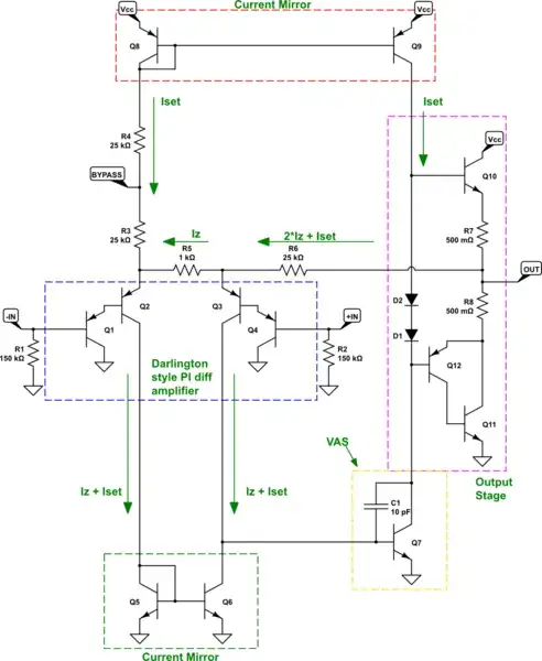

More Likely Example Case
A better example would include a more complex circuit (which as the one for the LM380.) This would help illustrate the knots of circuit groups that can be organized into separate sections (more tightly interwoven within themselves, but communicating to other sections via a sparser set of wires communicating signals.) So I'll end this by including a nicely divided LM380 schematic to illustrate that point:
schematic
Note that there are individual sections, now isolated as identifiable groups such as current mirrors, long-tailed differential amplifier (here, really, more of a \$\pi\$ type arrangement), and an output stage.
The annotations also help. In fact, if possible it is a good idea to include design-note annotations on your schematic. This helps to draw attention towards the key ideas relating schematic subsections to each other.
Try and imagine what this would have been like to read through had the power supply and ground rails been all connected up with additional wiring and/or with no particular arrangement of current flow on the page.

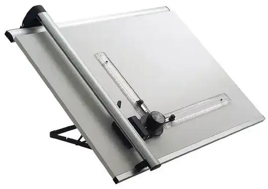

  • @jonk I almost bought a drafting table for 30 bucks with the xy ruler that glides on Mylar a couple days ago. I'm doing a simple 1m x 1m XYZ digital controlled gantry table to measure EH fields for a post grad for him to measure EV charge coil model designs. But decide to make from scratch with an ME who has 2 self modified Bridgeports and Autocad – Tony Stewart EE75 Jun 03 '17 at 15:49

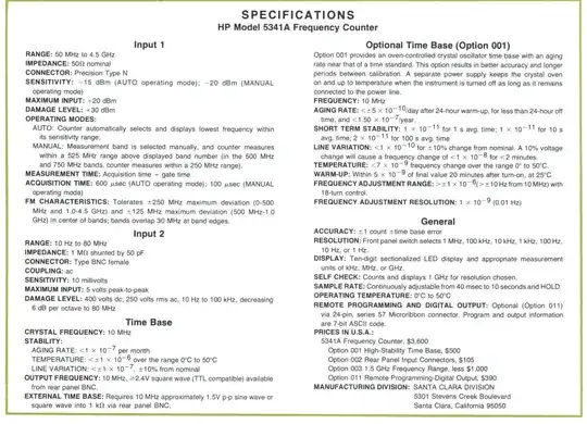

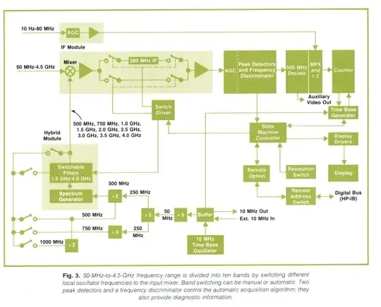

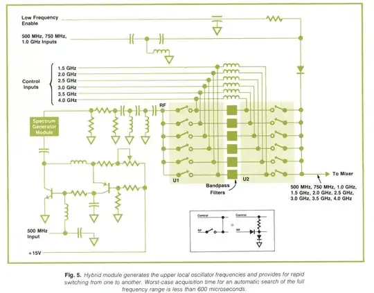

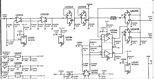

Here's a 4.5 GHz counter simplified schema & block diagram from the HP journal for an instrument we bought in 1976 with 1 Hz resolution:
Enter image description here
When I ask OPs or users for specifications, I expect they will learn to have details like this and share the relevant ones. But often they are oblivious to the need for good specifications to make a good design.

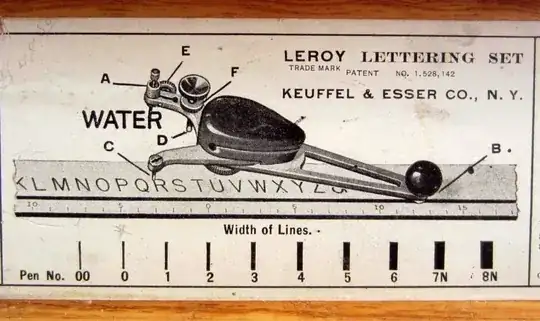

and the Leroy lettering system patented in 1925.
  • These are worth over $1k now and I had chance to get a used one for $30 but decided I needed it inverted for a gantry Automated test project with flying magnetometer. athey also hung CFL magnifying lamps on them for the older draftsmen with weaker eyes and of course electric spinning erasers and mastic erasers. – Tony Stewart EE75 Jun 03 '17 at 16:10
    There were template for letters too, I used them during study. Other templates for squares, circles and triangles of different sizes. Also templates for electronic symbols like resistors, diodes and transistors. But the SN74xx series was to complex for using templates. But I could use the template for rectangles to draw counters and registers and so on. – Uwe Jun 03 '17 at 21:31
  • During my entirely too brief time doing any drafting work, lettering templates were the only thing that helped my drawings stay clean. I'm left-handed and the only way I could letter free-handed without creating a mess was to letter right-to-left. One of my clients at the time was very blunt and told me I had no future as a draftsman. Which was good, because I switched majors from Mechanical Engineering to CompSci and never drew prints ever again. – Julie in Austin Jul 15 '19 at 02:41
