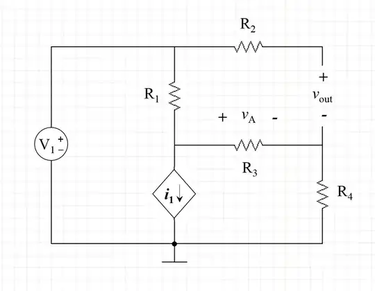

A linear circuit is shown in the figure below
Text
The VCCS (voltage controlled current source) is defined as 1= ⋅ .
The other elements in this circuit have the following values: 1=3.3Ω , 2=8Ω , 3=1.8Ω , 4=1.8Ω , =1.5/ , and 1=5 .
(a) Calculate the numerical value of the voltage in .
(b) Calculate the numerical value of the voltage in .
(c) Calculate the numerical value of the Thevenin equivalent resistance, in Ω , as seen from the terminals of .

    Welcome to EE.SE! Is this homework? Please show what you have tried so far. – winny Aug 06 '20 at 16:31
  • So I've tried using KCL and KVL and making a system of equations to try to figure this out but each time I submit it, it tells me that I'm getting the wrong answer. Do you have any pointers or suggestions? – John Aug 06 '20 at 16:33
    For sure. 1. Is this homework? 2. Please show your proposal with equations for the system with KVL and KCL? – winny Aug 06 '20 at 16:36
    When you wrote KCL, what current did you assume flowed through R2 ? – AJN Aug 06 '20 at 16:57
    Can you clarify what your assumption was ? – AJN Aug 06 '20 at 17:13
    Please show your KCL equations. – The Photon Aug 06 '20 at 17:15
    Also, please edit your title to describe the question at all. – Marcus Müller Aug 06 '20 at 17:25
  • You need to show a significant amount of your own effort. This isn't Chegg. – Elliot Alderson Aug 06 '20 at 22:03
  • @ElliotAlderson the issue is that I have no clue how to get started with this question. I'm not doing this for a class, this is a personal study thing – John Aug 06 '20 at 22:05
  • @ElliotAlderson Hmm. In 2018, "Chegg Services Revenues grew 35% year-over-year to $81.7 million." I could live with that. – jonk Aug 07 '20 at 01:20
  • @jonk Yeah, maybe if I got a piece of it. But we are giving away our labor here for free and someone else is "monetizing" it. That makes me feel OK about taking the ethical high ground. – Elliot Alderson Aug 07 '20 at 01:59
  • ”So I've tried using KCL and KVL and making a system of equations to try to figure this out” and ”the issue is that I have no clue how to get started with this question” are very contradictory. Please show your system of equations or this question will be closed due to insufficient own effort. – winny Aug 07 '20 at 06:46
  • I’m voting to close this question because homework without own solution provided. – winny Aug 07 '20 at 17:13
  • boii we already figured it out. Im gonna do some more self-studying on Thevenin stuff and come back to it. – John Aug 07 '20 at 17:17

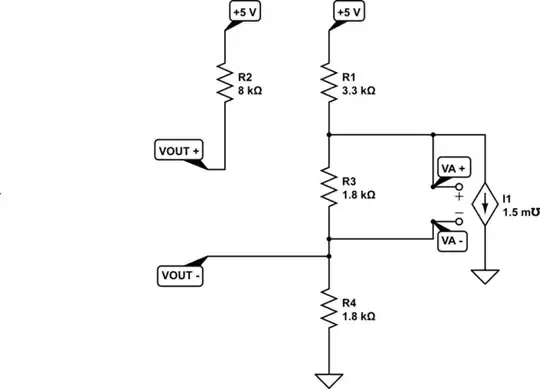

Redraw Schematic
At your stage in the game, I recommend that you redraw every schematic. In fact, you should redraw a schematic over and over until it "looks better" to you. There are some general helpful rules (I'll mention them, shortly, in the Appendix below.) But they are only a guide. An issue is that you need to develop a sense about things and, over time, to also acquire some standard thinking tools that allow you to more rapidly work out how better to redraw a schematic. Practice plays a huge role in developing those tools. So do not shy away from redrawing schematics. It should become second nature to you.
For example, here's what my mental tools suggested I should draw:
schematic
(Note: In the above schematic, \$V_\text{A}^-=V_\text{OUT}^-\$.)
The above schematic draws your attention to a simple three-resistor divider from the \$+5\:\text{V}\$ rail towards the ground reference. It then adds the current sink, controlled by a voltage, on the right side. On the left side, you can then see the final addition -- the output voltage arrangement.
These things may help you in attempting to correctly write your equations. For example, it is very easy to observe that without the current sink your problem would be quite trivial. But that with its complicating addition, it's really fairly simple as it only draws current out of one node, sinking it to ground. Yes, doing so alters that node's voltage and also the voltage across \$R_3\$, but this clearly isn't rocket science, either.
It's also crystal clear (or should be) that you only need two equations in two unknowns to get started. You will, of course, need a separate approach to produce a Thevenin resistance as seen from the \$V_\text{OUT}\$ pin-pairs. But actually that's just the same two equations but with the addition of one change before solving again. So it's not that bad, really.
Does this help in any way?
Nodal Analysis (KCL)
You wrote:
This is a self-learning thing I've been doing over the summer
So I'll try to walk you through the pair of KCL equations that, when solved simultaneously, should provide a starting point for achieving (a) and (b). I'll also add another thought about how to achieve (c).
All of the currents flowing out of a node (left side of the equations below) must equal the currents flowing into a node (right side of the equations below.) Although the method I use for setting up the equations correctly isn't often taught, it is how one of the steps of Spice handles things and I find using the idea helps me avoid uncaught errors when on automatic pilot. In short, it just flows out, easily. Follow along and see if you understand what I did.
So here it is:
$$\begin{align*} \frac{V_{\text{A}}^+}{R_1} + \frac{V_{\text{A}}^+}{R_3} + I_1 &= \frac{5\:\text{V}}{R_1} + \frac{V_{\text{A}}^-}{R_3}\\\\ \frac{V_{\text{A}}^-}{R_3} + \frac{V_{\text{A}}^-}{R_4} &= \frac{V_{\text{A}}^+}{R_3} + \frac{0\:\text{V}}{R_4} \end{align*}$$
Now, you separately know that \$I_1=1.5\:\frac{\text{mA}}{\text{V}}\cdot \left( V_{\text{A}}^+ - V_{\text{A}}^- \right)\$. So the final arrangement is:
$$\begin{align*} \frac{V_{\text{A}}^+}{R_1} + \frac{V_{\text{A}}^+}{R_3} + 1.5\:\frac{\text{mA}}{\text{V}}\cdot \left( V_{\text{A}}^+ - V_{\text{A}}^- \right) &= \frac{5\:\text{V}}{R_1} + \frac{V_{\text{A}}^-}{R_3}\\\\ \frac{V_{\text{A}}^-}{R_3} + \frac{V_{\text{A}}^-}{R_4} &= \frac{V_{\text{A}}^+}{R_3} + \frac{0\:\text{V}}{R_4} \end{align*}$$
If you solve those, you'll have both \$V_{\text{A}}^+\$ and \$V_{\text{A}}^-\$. That will answer (a), directly. Separately, since you know \$V_\text{A}^-=V_\text{OUT}^-\$ and, without any current in \$R_2\$, also know that \$V_\text{OUT}^+=5\:\text{V}\$ then you have an answer for (b), too.
To answer (c), all you need to do is short out the \$V_\text{OUT}\$ terminals and find out what current flows in \$R_2\$. If you divide the open-circuit voltage for \$V_\text{OUT}\$ (determined already in (b) above) by the short-circuit current (which is the same as the current in \$R_2\$ as \$R_2\$ is directly in series with the short-circuit, itself), you'll have your resistance in hand, as well. To implement this idea for (c), you will need to modify the above equations to reflect \$R_2\$'s presence and then solve them again. From the newly computed \$V_{\text{A}}^-\$, you can get the current in \$R_2\$.
Keep in mind that you need to modify one of the above two equations in order to incorporate \$R_2\$ and compute the information needed to find the short-circuit current. Suppose \$V_\text{CC}=5\:\text{V}\$, the open-circuit equations solve for \$^\text{OC}V_{\text{A}}^-\$ and \$^\text{OC}V_{\text{A}}^+\$, and the closed-circuit equations solve for \$^\text{SC}V_{\text{A}}^-\$ and \$^\text{SC}V_{\text{A}}^+\$. Then the Thevenin resistance will be:
$$R_\text{TH}=R_2\cdot \frac{V_\text{CC}-\:^\text{OC}V_{\text{A}}^-}{V_\text{CC}-\:^\text{SC}V_{\text{A}}^-}$$
