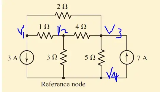

I am a bit confused as to where I have gone wrong in my nodal analysis calculation:
For the first node v1:
$$-3=(v1-v3)/2 +(v1-v2)$$
v2:
$$-(v1-v2)-(v3-v2)/4 = v2/3$$
v3:
$$7=(v3-v4)/5+(v3-v2)/4+(v3-v1)/2$$
v4:
$$-7=(v4-v3)/5$$
From this I get v1=6.42, v2=9, v3=7.29, v4=-27.7 which is incorrect according to my textbook. Any help with regards to where I have gone wrong in my calculation will be greatly appreciated.

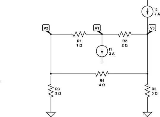

Here is my re-drawing of the schematic:
schematic
I've numbered the resistors by their values and I've picked a ground (the same one as indicated on your schematic) which does simplify the analysis as \$V_4=0\:\text{V}\$. Note also that the ends of current sources going to known voltage references can be dropped. And since the ground reference is, by definition, a voltage source there's no need to show those ends of \$I_1\$ and \$I_2\$.
You only have three voltages to solve: \$V_1\$, \$V_2\$, and \$V_3\$. So, just three equations are needed:
$$\begin{align*} \overbrace{\begin{array}{r} \frac{V_1}{R_1} + \frac{V_1}{R_2} + I_1 \vphantom{\frac{V_1}{R_1} + \frac{V_1}{R_2} + I_1 = \frac{V_2}{R_1} + \frac{V_3}{R_2}} \\\\ \frac{V_2}{R_1} + \frac{V_2}{R_3} + \frac{V_2}{R_4} \vphantom{\frac{V_2}{R_1} + \frac{V_2}{R_3} + \frac{V_2}{R_4} = \frac{V_1}{R_1} + \frac{0\:\text{V}}{R_3} + \frac{V_3}{R_4}} \\\\ \frac{V_3}{R_2} + \frac{V_3}{R_4} + \frac{V_3}{R_5} \vphantom{\frac{V_3}{R_2} + \frac{V_3}{R_4} + \frac{V_3}{R_5} = I_2 + \frac{V_1}{R_2} + \frac{V_2}{R_4} + \frac{0\:\text{V}}{R_5}} \end{array}}^{\text{outward directed currents}} &{\begin{array}{c} \vphantom{\frac{V_1}{R_1} + \frac{V_1}{R_2} + I_1 = \frac{V_2}{R_1} + \frac{V_3}{R_2}} =\quad \\\\ \vphantom{\frac{V_2}{R_1} + \frac{V_2}{R_3} + \frac{V_2}{R_4} = \frac{V_1}{R_1} + \frac{0\:\text{V}}{R_3} + \frac{V_3}{R_4}} =\quad \\\\ \vphantom{\frac{V_3}{R_2} + \frac{V_3}{R_4} + \frac{V_3}{R_5} = I_2 + \frac{V_1}{R_2} + \frac{V_2}{R_4} + \frac{0\:\text{V}}{R_5}} =\quad \end{array}} \overbrace{\begin{array}{l} \vphantom{\frac{V_1}{R_1} + \frac{V_1}{R_2} + I_1 = \frac{V_2}{R_1} + \frac{V_3}{R_2}}\frac{V_2}{R_1} + \frac{V_3}{R_2} \\\\ \vphantom{\frac{V_2}{R_1} + \frac{V_2}{R_3} + \frac{V_2}{R_4} = \frac{V_1}{R_1} + \frac{0\:\text{V}}{R_3} + \frac{V_3}{R_4}} \frac{V_1}{R_1} + \frac{0\:\text{V}}{R_3} + \frac{V_3}{R_4} \\\\ \vphantom{\frac{V_3}{R_2} + \frac{V_3}{R_4} + \frac{V_3}{R_5} = I_2 + \frac{V_1}{R_2} + \frac{V_2}{R_4} + \frac{0\:\text{V}}{R_5}} I_2 + \frac{V_1}{R_2} + \frac{V_2}{R_4} + \frac{0\:\text{V}}{R_5} \end{array}}^{\text{inward directed currents}} \end{align*}$$
Note: Voltage spills away from a node via available paths and voltage spills into a node from nearby nodes via the same available paths. The only caveat is that a current source can only flow into, or flow out of, a node. But not both directions. (Current sources only work one way. So it will either appear on the outward-flowing side or on the inward-flowing side -- but not both sides.)
Another Note: If you think about adding \$V_4\$ such that it would add one more equation, it will yield a singular matrix. A way to understand this is to note that voltages are not absolute values, but always with reference to another node. Or put still another way, what would be the difference between a solution with \$V_1=50\:\text{V}\$, \$V_2=60\:\text{V}\$, \$V_3=70\:\text{V}\$, and \$V_4=25\:\text{V}\$ and a solution with \$V_1=1050\:\text{V}\$, \$V_2=1060\:\text{V}\$, \$V_3=1070\:\text{V}\$, and \$V_4=1025\:\text{V}\$? There would be no difference. It's just offset. But against what, exactly? So you always need a reference when solving. Keep it in mind. It's not just a good idea, it's the law!

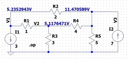

And a convenient Spice run (using LTspice) to see what it delivers from your schematic:
Nice match and that's about all there is to it.
