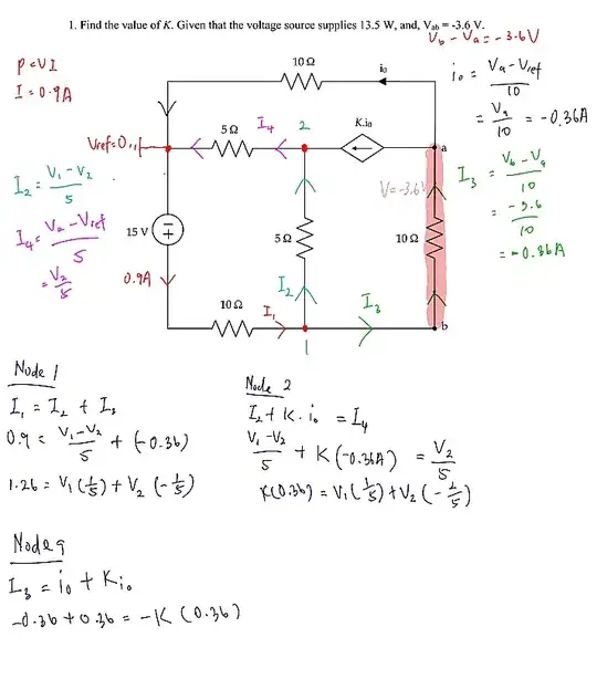

My question
The question has provided power supplied by the voltage source and Vab = -3.6 V. I had tried several ways but still can't solve it.
Below is the solving steps I tried: Tried solving steps
Bryan Soh
  • It looks like we have more known variables than equations. I mean, if we knew K but didn't know Vab nor the power supplied by the source, we could solve for all the voltages and currents. In your example, we don't know K, but we know Vab, so we still have as much unknowns as equations. I don't see it necessary to use the power supplied by the source. – alejnavab Nov 04 '20 at 13:54

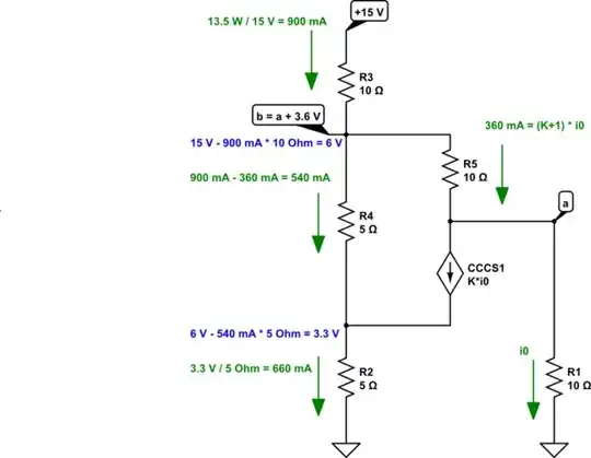

I always first redraw a schematic. It often helps me to see better. In this case, a lot better. (See appendix below.)
schematic
The added notes were easily applied. First, I was able to compute the current in \$R_5\$ (it's obvious from the specifications.) Similarly easy is the current in \$R_3\$, as the power is already given. From this, node b's voltage is easily worked out and therefore also node a's voltage. (You can immediately work out i0 at this point, but I left that out for now.) What's left from \$R_3\$'s current, after subtracting \$R_5\$'s current, must be flowing in \$R_4\$. This then allows you to work out the voltage at the opposite side of \$R_4\$ and therefore also the current in \$R_2\$.
With all those details worked out, you now must know the current in CCS1 (the difference between \$R_4\$'s current and \$R_2\$'s current), then also the current in \$R_1\$ (which could have been earlier computed), and therefore trivially the value of K.
I don't see a need for nodal analysis, or mesh. It all just falls out, quickly.
Learn to redraw schematics. It's important.
