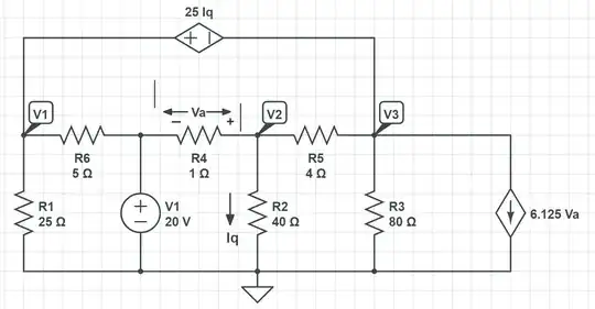

All the information of the circuit elements are shown below.
Question : Use the node-voltage method to find the power developed by the 20V source in the circuit. enter image description here
    Can you show what you have tried? It will be a lot easier to point out where you went wrong, or give you hints. Otherwise, people will have to guess and they don't like that very much. This being a Q&A site, after all. – a concerned citizen Dec 13 '22 at 19:39
  • Of course. I shared now. – Electronics00 Dec 13 '22 at 19:44
    Have you heard of Latex language used to express equations without any suspicion of misreading a handwritten formula? – Andy aka Dec 13 '22 at 19:47
  • No. I didn't hear. – Electronics00 Dec 13 '22 at 19:49
    $\dfrac{V_i-20}{5}$ = \$\dfrac{V_i-20}{5}\$ ||| I have no idea where the 20 comes from because I can't read your handwriting = the source on the left looks like 25 volts to me. Do you see the problem? – Andy aka Dec 13 '22 at 20:01
  • V1-20/5 --- and this is 20V. I understand what you say. If you can do question from the question image, you can send me. Thank you – Electronics00 Dec 13 '22 at 20:17
  • @Electronics00 Look closely at your hand-drawn schematic with the equation work (2nd picture) and your top (first) schematic. Now look at the resistor value showing in the 1st schematic above -- the one on the far left that is labeled 25 Ohms. Now look at your 2nd hand drawing for the same resistor. Do I see the number 6 Ohms there??? And in your equations, as well? What's going on? What's the truth? Hard to help you with errors if things don't match up. – jonk Dec 13 '22 at 20:43
  • You can look again to circuit – Electronics00 Dec 14 '22 at 15:08

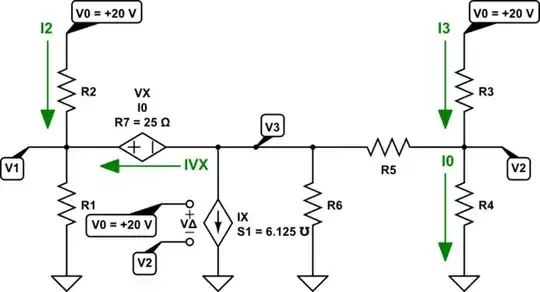

Habitually redraw schematics
Just the manual process redrawing a schematic helps me think and gather up details I may otherwise fail to notice. It also helps readability, once you learn better how to apply some rules for redrawing. (See Addendum below for a few suggestions.)
Use the schematic editor
There's another reason for redrawing your schematic. You've provided no part numbers. It greatly helps when communicating if things are uniquely identified. So also get into the habit of using the schematic editor here. It will automatically number the parts.
Your schematic, redrawn
schematic
I've added \$I_{_2}\$ and \$I_{_3}\$, because the question wants to work out the power of the source I labeled as \$V_{_0}\$. (I'm guessing from the wording ("developed in") that the magnitude is sufficient, though a sign might be of further help.) The magnitude of the power will be \$\vert V_{_0}\cdot\left(I_{_2}+I_{_3}\right)\vert\$.
With the exceptions (for clarity only) of showing \$V_{_0}=+20\:\text{V}\$, \$S_{_1}=6.125\:\mho\$, and \$R_7=25\:\Omega\$ on the schematic, I've left all of the remaining values unspecified. I can't tell from your original diagram and the following one which values to use. You know. So work it out. But at least the rest is labeled so we know what we are talking about.
One thing I can immediately see from your writing is that you define \$V_{\Delta}=V_{_2}-20\:\text{V}\$. But this is not correct, as the sign is wrong. It's clearly labeled on the schematic so that you should instead have found that \$V_{\Delta}=V_{_0}-V_{_2}=20\:\text{V}-V_{_2}\$. So already that's one mistake.
And I'm curious. Given my schematic and part labels, what is the value of \$R_1\$ supposed to be? I can't tell from your question.
I'll stop there until I hear more from you.
Added since your question edit
You've edited your question to clarify the part values and numbering, though now there's a new communication problem as our schematics no longer match up with the same numbering for the same parts.
Also, you've removed the picture of your attempt to solve the problem. So the only way I can find it (and it is only because I have enough of the 'silly site score' that allows me) is to go backwards through your edits to uncover it. For those who cannot do that and even for those of us who can, it might help still further if you could put in some added moments of your time to include your mathematical work here in your current edited question.
So here's what I see:
  1. Given this enter image description here assignment of signs, your writing enter image description here should instead be \$V_{\Delta}=20\:\text{V}-V_2\$ .
  2. List item Correct.
  3. enter image description here With the correction I've made and recognizing that what looks the same as elsewhere where you write a 4 is instead really a 6 then this is correct.
  4. I must be missing where you performed the KCL for \$V_2\$. It looks more to me as though you just proceeded towards a solution without it. But maybe I'm just having a hard time reading you.
Assuming I'm forced into using supernodes (I don't like them as they make it easier to generate mistakes, in my opinion), then I would have developed the following (keep in mind I will be using my part number assignments and not those you newly created):
$$\begin{align*} \frac{V_1}{R_1}+\frac{V_1}{R_2}+\frac{V_3}{R_5}+\frac{V_3}{R_6}+S_1 V_\Delta &= \frac{V_0}{R_2}+\frac{V_2}{R_5} \\\\ \frac{V_2}{R_3}+\frac{V_2}{R_4}+\frac{V_2}{R_5}&=\frac{V_0}{R_3}+\frac{V_3}{R_5} \\\\ V_1&=V_3+R_7 \,I_0 \\\\ I_0&=\frac{V_2}{R_4} \\\\ V_\Delta &= V_0-V_2 \end{align*}$$
The first is your supernode. And the rest should be pretty obvious. If you want, the last three can also be combined together into the first 'supernode' KCL equation, leaving just two equations and two unknowns, if you want. Regardless, as shown above, these do solve out. And you should be able to then work out the requested power figure from there.
