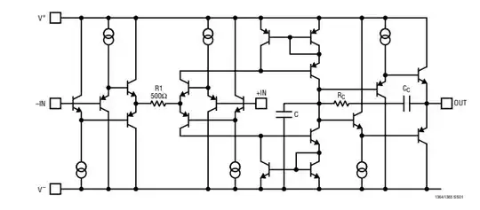

I had a look at the internal diagram of the op-amp and noted that it had a input stage quite similar to a current feedback amplifier. Is that the reason why behaves so different to other op-amps I own? (Like the LF356, 4558D, 741, TL072, etc.)

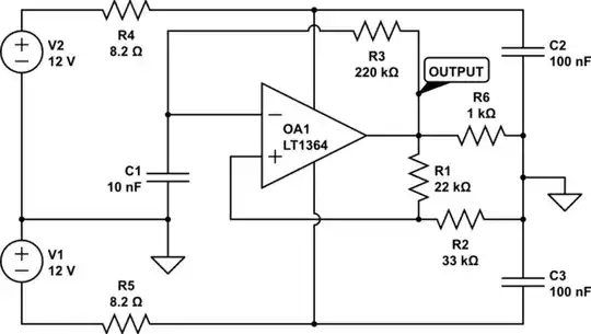

Schematic of what I had used while playing with the LT1364s I own:
schematic

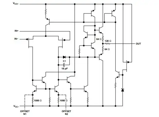

With this set-up, the current draw on the dual power supplies is around 22mA. The same circuit is mirrored on the other op-amp package on the chip. For ease of reference, here is the datasheet provided internal circuit of the LT1364. LT1364 internal circuit And the venerable TL07xx series(of which I use the TL072 more often) TL07xx internal circuit
As seen, the two input stages are definitely different, the LT1364's looking more like one of those CFOAs. Is this why the performance is different? Perhaps I am using it wrongly?

That schematic was most confusing the way it was drawn! See Jonk's two rules on Learning How to Draw Schematics.
Why do you have positive feedback (R1) and gain that gets very high at higher frequencies (C1)?
The quiescent current draw is around 6mA. At 24V that amounts to 144mW. The LT1364 has two sections, so, that's 288mW. On page 10 of the LT1364 data sheet you'll find that the junction to ambient thermal resistance is 130°C/W. Thus, you would expect the junction temp to be around 62°C = 130°C/W * 0.288W. Not horrible, but getting on uncomfortable to touch. Of course the case temp will be less, but that depends on a lot of variables.
The next thing is your output is probably pegged to the power supply rail since you have positive feedback. Closer examination, your circuit is an oscillator. A check with an oscilloscope or volt meter will verify this. If it's pegged to the rail, then you have extra current draw through the output resistor and feedback network which will add extra power dissipation.
Try make a proper negative feedback topology, get rid of the positive feedback and see if things get better. Be sure to use an oscilloscope to monitor the output and make sure it isn't oscillating. If you reduce the power supply voltages, this will get cooler.

  • Yep, it is an oscillator. And the reason why the circuit is confusing is because I am not used to drawing circuits on computer; I am more comfortable drawing it on paper, so I am still learning. Thank you for sharing your knowledge on this. I can now rest well knowing that my chip is behaving good! But I have some questions. What did you mean by proper negative feedback, and what did you mean by positive feedback? – Tomiko Aug 16 '21 at 07:09
  • @Tomiko You stated that you are trying to "build a differential probe", not an oscillator. I assumed your schematic was an attempt at making an amplifier for such a probe. Positive feedback is when the output is fed back to the plus-input. There are legitimate reasons for doing this, however, in an amplifier you strive to have negative feedback only (output being fed to the minus-input). "Proper" relates to C1 going from common to the negative input which makes a differentiator circuit (if you feed an input signal thru the capacitor), not an amplifier circuit. – qrk Aug 16 '21 at 18:44
