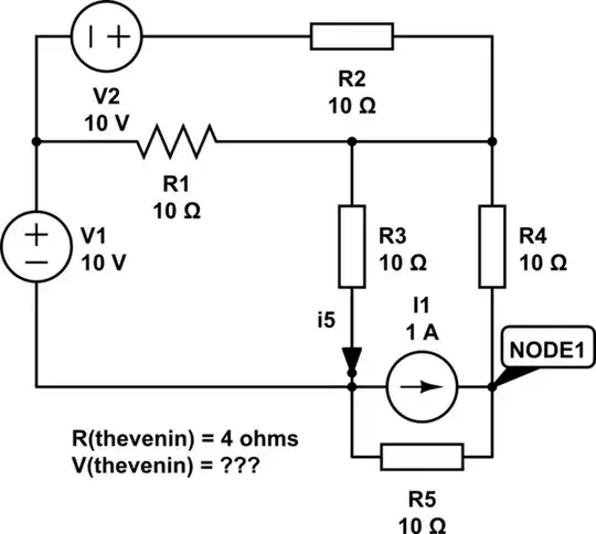

I need help solving the following circuit using the Thevenin method:
schematic
The unknown in this problem is current i5, the correct answer is -1A.
I have already solved for the R(thevenin) by getting rid of all current and voltage sources and replacing them with either an open circuit or a short circuit, the resistance was correctly found to be 4 ohms.
However, I'm not quite sure how to calculate the V(thevenin)in order to reduce this circuit down to a Thevenin circuit. I have tried nodal analysis using node 1 and replacing the currents with differences in potential divided by the resistance but had no luck... any ideas on how to calculate Vth.
Thank you.
My mathematical approach so far:
Once all the dependent sources have been removed and replaced correctly, I see that (((R3+R4) || R6)||R2), calculating this gives ((20||10)||10) --> 4 ohms.
At node 1, I speculated that a current i1 might be going through the R4, the current source is giving a current of i2 = 1A and i3 is leaving the node through the remaining side, so i1+i2 = i3.

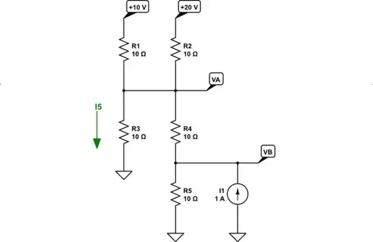

You get to assign \$0\:\text{V}\$ to exactly one node in a circuit. I've chosen one in the following case:
schematic
Here, you can see there are only two nodal equations required by the circuit, so that means two equations and two unknowns. Once you know the value for \$V_\text{A}\$ you will know the exact value for \$I_5\$, as indicated in the diagram.
Thus:
$$\begin{align*} \frac{V_\text{A}}{R_1}+\frac{V_\text{A}}{R_2}+\frac{V_\text{A}}{R_3}+\frac{V_\text{A}}{R_4}&=\frac{10\:\text{V}}{R_1}+\frac{20\:\text{V}}{R_2}+\frac{0\:\text{V}}{R_3}+\frac{V_\text{B}}{R_4}\\\\ \frac{V_\text{B}}{R_4}+\frac{V_\text{B}}{R_5}&=\frac{V_\text{A}}{R_4}+\frac{0\:\text{V}}{R_5}+1\:\text{A} \end{align*}$$
Are you able to go from here?
(You could also just Thevenize your way through this without nodal analysis, I suppose.)
