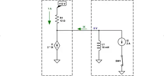

Case: \$t\to\infty\$

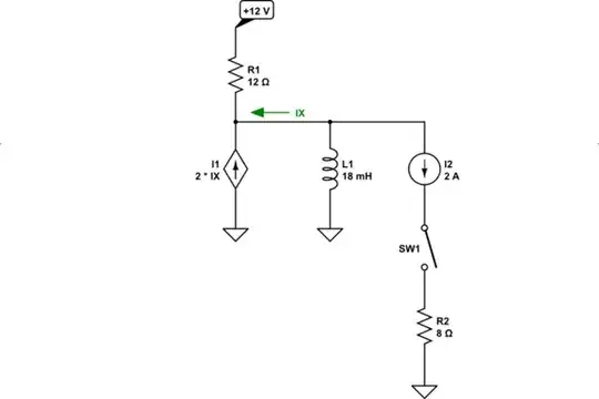

Always redraw the schematic. Even if you don't entirely want or need to. It's just good practice to get into. See the Appendix below for details.
I'll just redraw the entire schematic as you have it, at first:
schematic
Now, for the case with \$t\to\infty\$, the switch has been closed a long time and therefore there is no changing current in \$L_1\$ and thus no voltage drop across it. Also, \$R_2\$ simply does not matter. \$I_2\$ has infinite impedance and the little \$R_2\$ is completely irrelevant. It cannot be seen by anything on the other side of \$I_2\$. So \$R_2\$ can be shorted out without any loss in finding your answer.
The new schematic (showing a closed switch) is:
schematic
simulate this circuit
As the node voltage is still \$0\:\text{V}\$, there is still \$1\:\text{A}\$ in \$R_1\$ with the direction, as shown. Obviously, you still also have \$I_1=-\frac23\:\text{A}\$ and \$I_X=-\frac13\:\text{A}\$. There's clearly no other option.
By simple inspection, you can see that there is \$\frac13\:\text{A}\$ flowing into the node within the right-side box. (If it helps you, imagine a \$0\:\text{V}\$ voltage supply replacing the wire between the two boxes, again without loss to the analysis, as a way of isolating the node into two parts.) There is also clearly \$2\:\text{A}\$ flowing out of that same node. So \$L_1\$ must be supplying the remainder: \$2\:\text{A}-\frac13\:\text{A}=1\frac23\:\text{A}=\frac53\:\text{A}\$.
That's the magnitude. I'm sure you can work out the direction.

  • Thank you very much for such a detailed answer to my question. I can see where I was going wrong. I was including the 8 ohm resistor as well as the 2A current in my calculation for the KVL, instead of omitting them. The way you drew your schematic makes the circuit look WAY simpler and easier to understand. This is the first time i have seen it drawn like this, but will definitely be reading the link you provided as well as practicing. – Etlewisg Nov 04 '20 at 20:29
  • @Etlewisg I'm still practicing. So never stop. It's just good stuff. Follow the guidelines, but don't imagine they are absolute. Sometimes, or actually helps to violate one. But until you are able to know when, follow them closely. It really will help you. – jonk Nov 04 '20 at 20:34
  • I have one more question pertaining to the Eq Resistance as seen by the inductor. I did the calculations as shown in my work and got Req=36 ohms. That is curious since the only active resistor in the circuit is the 12 ohm. Is that due to the controlled current source? – Etlewisg Nov 04 '20 at 20:42
    @Etlewisg Yes. The dependent source "soaks up" 2/3rds of the current in the 12 Ohm resistor. So, shorted, only 1/3rd of the current is observed externally; the other 2/3rds being sunk by the dependent current source, internally. But left open, the output actually shows 12 V (and the dependent current source is at 0 A, of course.) So you get 12 V divided by (1/3 A) or 36 Ohms. – jonk Nov 04 '20 at 23:09
