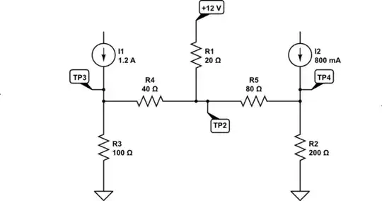

I have come across the the circuit below and found it to be difficult to figure out what the node voltages are. I implemented it on circuit wizard as below. Can someone please explain how to work out the node voltages at TP2, TP3 and TP4? Thank you! enter image description here?

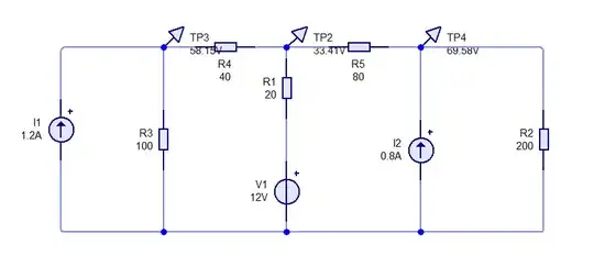

Attempt:

    Show us what you have done and we will see where you are having trouble. – relayman357 May 05 '21 at 12:45
  • This looks like a homework or exam question so we won't just give you a solution. You need to show us that you have made a substantial effort to solve this yourself. Show us all of your work and explain specifically where you got stuck. – Elliot Alderson May 05 '21 at 12:55
  • @ElliotAlderson See update! – Fil May 05 '21 at 13:01
  • @relayman357 See update! – Fil May 05 '21 at 13:02
  • @ElliotAlderson it is a problem I recently came across during a circuit analysis electronics seminar. – Fil May 05 '21 at 13:06
    The voltages you use in your equations do not exist on your schematic. Please redraw the schematic to clearly indicate the location of these voltages. You should also mark which node is the reference node. – Elliot Alderson May 05 '21 at 13:41
    A 1.2 A seems to have changed to 12 in the topmost line of the handwritten note. In the second equation, there may be a sign error. What is the sign convention ? is current entering a node considered as positive or a current leaving the node ? Alternately mark the current directions also in the schematic. Signs cannot be checked without knowing the reference current directions. – AJN May 05 '21 at 13:45
  • @Elliot Anderson. Those voltage are simulated values. They are the voltage in question. – Fil May 05 '21 at 13:45
    The handwritten note calls the voltages VA,VB,VC. But the schematic has TPx. Avoid confusion by labelling the schematic and the equations the same way. Don't forget the reference current directions! – AJN May 05 '21 at 13:46
  • @Fil are you familiar with superposition ? – Hilmar May 05 '21 at 14:04
  • @Hilmar I am familiar with superposition. The problem is, applying KCL in branches involving both voltage and current sources are can be tricky. – Fil May 05 '21 at 15:11

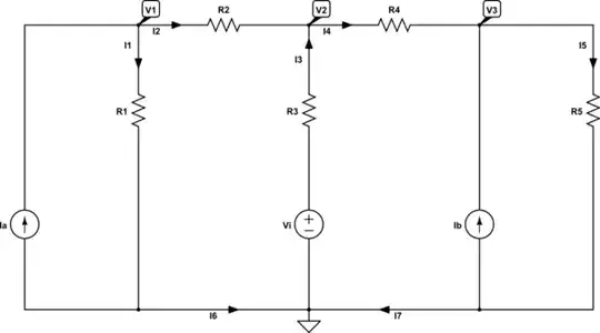

First, I will present a method that uses Mathematica to solve this problem. When I was studying this stuff I used the method all the time (without using Mathematica of course).
Well, we are trying to analyze the following circuit:
schematic
When we use and apply KCL, we can write the following set of equations:
$$ \begin{cases} \text{I}_\text{a}=\text{I}_1+\text{I}_2\\ \\ \text{I}_4=\text{I}_2+\text{I}_3\\ \\ \text{I}_5=\text{I}_\text{b}+\text{I}_4\\ \\ \text{I}_5=\text{I}_\text{b}+\text{I}_7\\ \\ \text{I}_3=\text{I}_6+\text{I}_7\\ \\ \text{I}_1=\text{I}_\text{a}+\text{I}_6 \end{cases}\tag1 $$
When we use and apply Ohm's law, we can write the following set of equations:
$$ \begin{cases} \text{I}_1=\frac{\text{V}_1}{\text{R}_1}\\ \\ \text{I}_2=\frac{\text{V}_1-\text{V}_2}{\text{R}_2}\\ \\ \text{I}_3=\frac{\text{V}_\text{i}-\text{V}_2}{\text{R}_3}\\ \\ \text{I}_4=\frac{\text{V}_2-\text{V}_3}{\text{R}_4}\\ \\ \text{I}_5=\frac{\text{V}_3}{\text{R}_5} \end{cases}\tag2 $$
Substitute \$(2)\$ into \$(1)\$, in order to get:
$$ \begin{cases} \text{I}_\text{a}=\frac{\text{V}_1}{\text{R}_1}+\frac{\text{V}_1-\text{V}_2}{\text{R}_2}\\ \\ \frac{\text{V}_2-\text{V}_3}{\text{R}_4}=\frac{\text{V}_1-\text{V}_2}{\text{R}_2}+\frac{\text{V}_\text{i}-\text{V}_2}{\text{R}_3}\\ \\ \frac{\text{V}_3}{\text{R}_5}=\text{I}_\text{b}+\frac{\text{V}_2-\text{V}_3}{\text{R}_4}\\ \\ \frac{\text{V}_3}{\text{R}_5}=\text{I}_\text{b}+\text{I}_7\\ \\ \frac{\text{V}_\text{i}-\text{V}_2}{\text{R}_3}=\text{I}_6+\text{I}_7\\ \\ \frac{\text{V}_1}{\text{R}_1}=\text{I}_\text{a}+\text{I}_6 \end{cases}\tag3 $$
Now, we can solve for:
  • $$\text{V}_1=\frac{6920}{119}\approx58.1513\space\text{V}\tag4$$
  • $$\text{V}_2=\frac{568}{17}\approx33.4118\space\text{V}\tag5$$
  • $$\text{V}_3=\frac{8280}{119}\approx69.5798\space\text{V}\tag6$$

  • @Jan, how do you figure out the direction of current in/out of the nodes. How would you know especially when looking at V1 and V3? I know any circuit simulator would tell me the directions which would then allow me to use KCL and work out the node voltages but the problem was on a piece of paper. – Fil May 05 '21 at 15:18
    @Fil I do not know, I just choose a direction and when solving the system of equations and the current is negative the arrow had to be in the other direction. – Jan Eerland May 05 '21 at 15:20
  • @Jan the downvote was not by me. As a matter of fact I think your solution is helpful but from a different approach. – Fil May 05 '21 at 15:26
  • @Jan could you elaborate on the "system of equations" that resulted in the negative current? This may as well be the breaking point. – Fil May 05 '21 at 15:29
