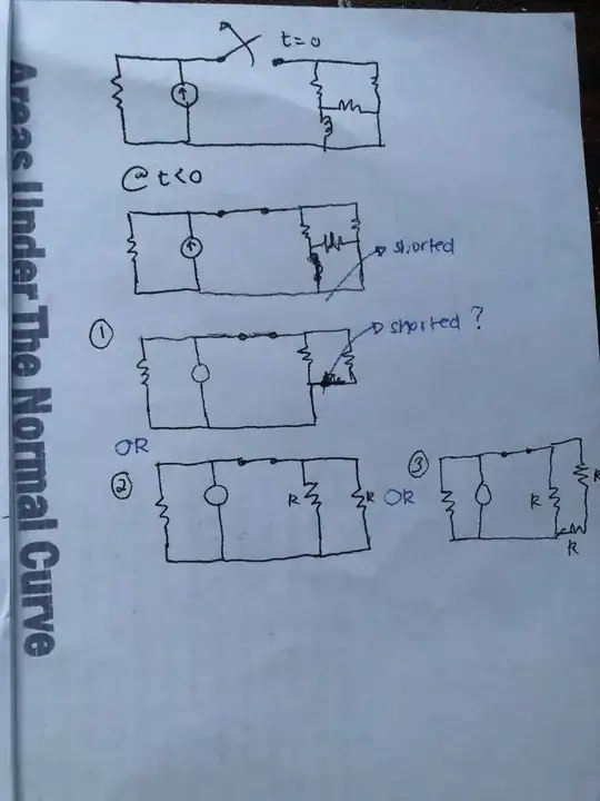

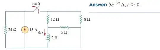

I do know that a resistor is by passed when parallel to a short circuit or wire with no branches. However what if it was within a complex circuit and not just in the outer loop how does that by-passed resistor affect the other multiple resistors connected in series/parallel with it. enter image description here
I end up with having 0 results in finding my i(t), it must be because i considered the entire right part to the current source as short thus shorting everything else. I lack knowledge in short circuits and how they affect COMPLEX CIRCUITS. i know how it affects it in a simple basic way but not when its already so complicated and connecte dwith varieous branches.
which of the following happens? 1, 2, 3 those are the possibilities ive come up with, im not sure which is the right one, is it 2?

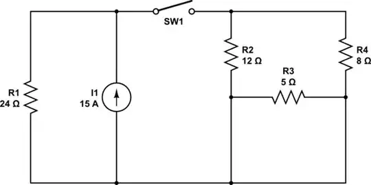

Habitually redraw schematics
The first thing I do before attempting to analyze a circuit is to redraw that circuit. The process of just doing it helps me think and gather up a few details that I may not notice so easily otherwise, just staring at someone's depiction. But it can often help readability. And that, too, improves understanding and reduces chances for mistakes, later. (And helps others who may look at what you produce.)
It does take lots of practice to accumulate a good sense about it. But that practice is well worth your time.
For more, see the Addendum at the end, below.
Use the schematic editor
There's another reason in this case for redrawing your schematic. There are no part numbers in your pasted picture. And since you are asking for communication with others, it helps a lot if things are uniquely identified so that the communication can be specific and more terse, saving space and reading and interpretation time for all. Please also get into the habit of using the schematic editor here -- especially if your picture doesn't have unique part numbering.
It just saves time for all and it is the considerate thing to do when asking others for their help.

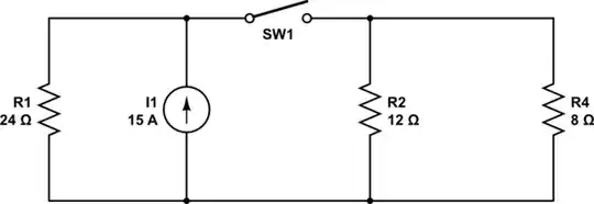

Your schematic, redrawn
Switch closed:
schematic
Can you now work out your answer from this? Would Thevenizing the Norton source, \$I_1\$ and \$R_1\$, help? Do you also see that \$R_1\$ and \$R_4\$ are in parallel and can be combined right away? What happens after a long time with \$L_1\$? The current would be constant, yes? And if so, then no time-dependent change anymore and therefore no voltage across \$L_1\$? What does that imply for \$R_3\$?
The above helps figure out the initial conditions for \$L_1\$.

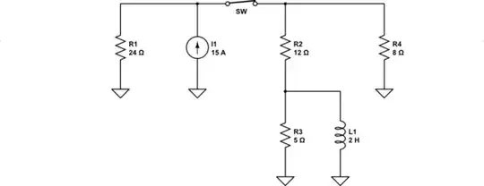

Switch open:
schematic
simulate this circuit
Once open, the subsection on left is no longer connected and isn't involved in further analysis. But given that you now know the initial conditions of \$L_1\$, you can readily work out the time-dependent behavior after the switch opens up. I would imagine now that \$R_3\$ appears to be in parallel with the series combination of \$R_2\$ and \$R_4\$. Not so?

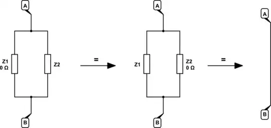

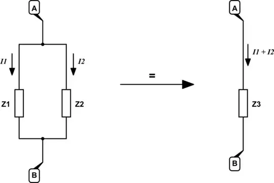

Regarding two-terminal devices in parallel with each other, you have this arrangement, where each impedance (even when the impedances are inductive or capacitive, resistive or any combination thereof) represented by \$Z\$:
schematic
$$ \begin{aligned} \frac{1}{Z_3} &= \frac{1}{\frac{1}{Z_1} + \frac{1}{Z_2}} \\ \\ Z_3 &= \frac{Z_1 Z_2}{Z_1 + Z_2} \end{aligned} $$
Clearly, if either impedance is zero, or in other words is a short circuit across the other, then the combined impedance is also 0Ω, and the pair can be replaced by a simple zero-ohm path:
schematic

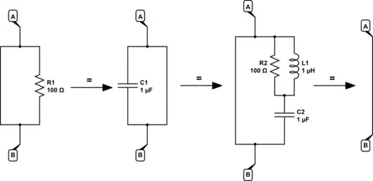

This principle applies to any short-circuited two-terminal device, or compound circuit with only two externally accessible terminals:
schematic
Theoretically (and in practice too, if you can somehow produce a true zero-impedance short-circuit), a zero-ohm path can have no voltage across it. If the short circuit impedance is \$Z_1=0\$:
$$ \begin{aligned} V_{AB} &= I \times Z_1 \\ \\ &= I \times 0 \\ \\ &= 0 \end{aligned} $$
Since both parallel elements (the short-circuit \$Z_1=0\$ and the element being shorted \$Z_2 \ne 0\$) have the same voltage across them, there can be no current passing through the non-zero impedance \$Z_2\$, by Ohm's law:
$$ \begin{aligned} I_2 &= \frac{V_{AB}}{Z_2} \\ \\ &= \frac{0}{Z_2} \\ \\ &= 0 \end{aligned} $$
Therefore the element being shorted circuited has:
  • No voltage across it
  • No current through it (all current passes via the short circuit)
Consequently, any application of Kirchhoff's voltage or current laws to that shorted device will yield a zero term, and disappear from the algebra entirely. In other words, the element can be removed completely (leaving just the short-circuit path) without affecting the state or behaviour of the entire circuit at all.

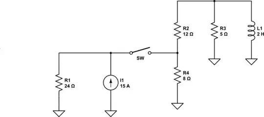

Knowing all that, your circuit can be reconstructed, in a step by step manner, removing any short-circuited components one by one. Start by shorting the inductor here:
schematic
Remove the inductor, leaving only the short circuit path:
schematic
Notice that R3 is now also short-circuited, so remove that too, leaving only the short-circuit path in place:
schematic
Notice how R2 an R4 are now in parallel and can be replaced by a single resistance. I won't do that here, you get the idea.
Proceed like this until you have a minimal circuit, then perform your analysis.
