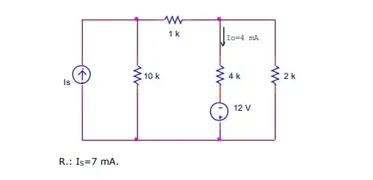

I need to calculate the current of Is, I'm stuck after getting the voltage across the 4k ohm resistor which is 16V.

You're on the right track. Keep calculating the voltage across and current through each element working your way "across" the circuit from right to left.
If the voltage across the 4k resistor is 16V what is the voltage across the 2k resistor? What is the current through the 2k resistor? What is the current through the 1k resistor and so forth...
- 1,486
- 9
- 12
Thank you! it was really confusing me since it was on one side 12 V in the 2k resistor and on the other 16V but that means it has -4V! managed to do it – André Páscoa Oct 15 '20 at 02:54

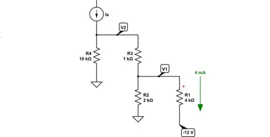

You are always allowed to select one of the wires (nodes) and designate it as \$0\:\text{V}\$ (or ground.) That is your prerogative. In the schematic below, I've chosen your bottom wire as ground.
Also, perhaps the easiest way to see is to practice redrawing schematics. I recommend early and continual practice at redrawing circuits to novitiates in electronics. It's an essential skill and it takes regular practice in order to yield some of its greater powers. (And see the appendix below for more details.)
You already know that when there is a current through a resistor, the more positive end is as shown. And since the voltage drop must be \$4\:\text{mA}\cdot 4\:\text{k}\Omega=16\:\text{V}\$, then you know what \$V_1\$ must be. Once you know that, you can compute the current in \$R_2\$. That current will add to the current already known through \$R_1\$ as: \$I_{R_3}=I_{R_1}+I_{R_2}\$. This makes it really easy to work out \$V_2\$. With that, you and work out \$I_{R_4}\$. Then it must be the case that \$I_S=I_{R_4}+I_{R_3}\$ and then you are done.
