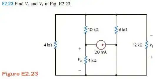

I started by combining resistors in parallel so instead of 4k and 12k I can get 3k but then as the independent current source exists in the middle confuses me what to do next. Can someone guide me through?

Good. Draw your new simplified circuit. How will the current branch according to KCL? – winny Jun 18 '20 at 20:51
I know that the sum of the currents from 10k and 4k resistors are 20mA but I'm not sure about the current at 6k resistor. How does this help? – Jinho L Jun 18 '20 at 20:56
Start with one thing at the time. From the (arrow) output side of the current source, there are two branches. Draw them and set up ohms law for each. – winny Jun 18 '20 at 21:01
I guess I can represent I as the current at 6k and the other as (20mA- I)? so using ohm's law I get 6kI if this is what you meant – Jinho L Jun 18 '20 at 21:07

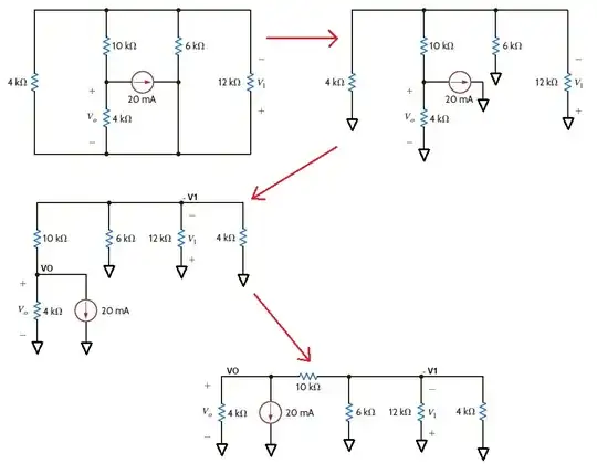

It often helps a lot to just re-draw the schematic:
You are allowed to pick any one node, your call, and simply say "this node is \$0\:\text{V}\$." Doing so can often help you sort out the rest.
(You can do this because otherwise, let's say, we add one million volts to all of the nodes of a circuit. Does that change the circuit? Nope. Still runs the same. So you can make an adjustment to all the nodes, so long as you make it equally to all of them. Turns out it is very convenient to make one of them exactly zero volts. As shown above.)

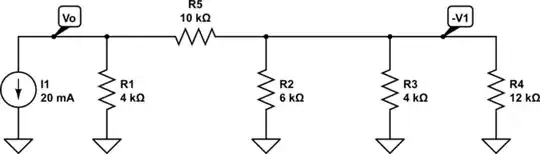

You should be able to see that I've correctly labeled the unknown nodes (just two of them.) I've negated \$V_1\$ in the schematic because that's how they want it performed, looking over their schematic and comparing it to what I developed above. It's now your goal to figure them out.
Here, you should be able to see some resistors in parallel, which can be immediately combined. You can also see how the current source and one of the resistors can be Thevenized before further steps where all you have left is a resistor voltage divider.
It shouldn't be that hard, from here. Do you see how much easier it is once you just sit down and re-draw a schematic for readability??

Instead, let's take your specific circuit and see what I did to it:
You should be able to see here how I achieved the new schematic form and you should be able to also recognize that I did not change it, at all. It's the exact same schematic, drawn differently.
