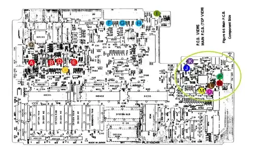

Not long ago, I have done some capacitor repairs after experiencing random reboots. I've skimmed through some online manuals, and it seems that somewhere in the circuitry around the on/off switch is somehow correlated with the reset button. I replaced all the bad capacitors in this section of the motherboard in this picture I found online.
  • I replaced P with an electrolytic cap. 0.47μF, 50V.
  • I replaced O with an electrolytic cap. 1μF, 50V.
  • I replaced J with an electrolytic cap. 4.7μF, 50V although the original is a 25V.
  • I replaced M with cap. 33μF, 16V although the original was a 10V.
I've replaced all 10uF 16v capacitors that are used for the display. Recently, I had to replace B and D as it was a bad solder.
I've damaged the trace near b and d but was working just fine and it hasn't severed the trace completely.
I checked the other in the circled that wasn't mentioned above and they did not leak. Although I had to desolder them and put them back again. I made sure that working old capacitors were properly seated and connected through the solder. I even checked the non-polarized C, and it was not leaking so I had to re-solder it carefully.

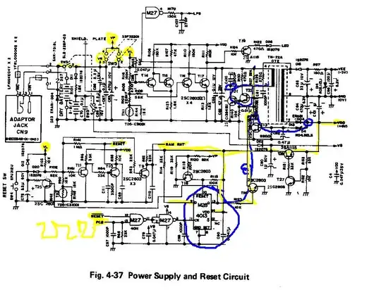

Somewhere in the service manual, it talks about a battery voltage detector. I suspect that since the capacitors in the circled area have gone bad is the culprit of the "reset." But I was mistaken. After replacing the bad capacitors I still was experiencing reset. So I decided I must have done an improper solder. I made certain that the solder sunk into the holes where the capacitors are supposed to be at and nothing but a black screen of death. I'm scratching my head right now. Did I short something by mistake?

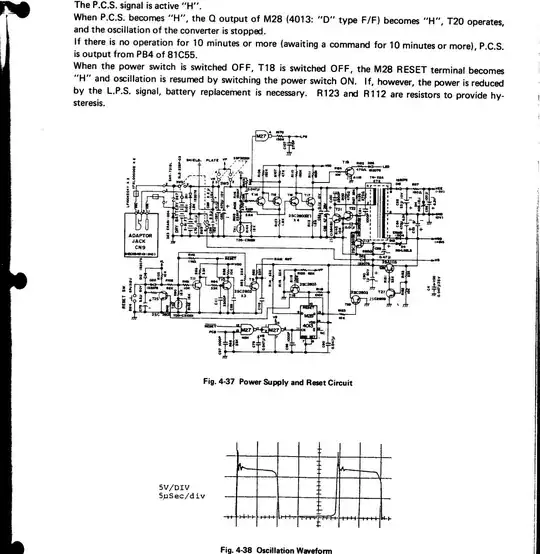

Here is the service manual, look for page 50
Here is the capacitor list and map.

    I can understand the schematics OK , but you need to make some DMM measurements and activate switches. Around the areas in Yellow then the PCS 40kHz clock with RESET hi going to the blue area of the DC-DC converter with +/-5V out https://i.stack.imgur.com/BQ6cA.png – Tony Stewart EE75 Mar 10 '19 at 04:32

  • +Sunnyskyguy EE75 I looked at the schematic and noticed that at M28 is covered with some corrosion. I cleaned it and it doesn't work. Just a screen that turns on with nothing. – Travis Wells Mar 10 '19 at 16:24

  • @OptionParty Well, I got it to turn on with just lines. I managed to yank out the pads for the b and d caps and created new "pads" with solder. I replaced all the capacitors again in the circled area. Even the ones used for the display (eg. a-e in red) Yesterday, I did get it to run properly showing basic. But it failed. – Travis Wells Mar 12 '19 at 03:32
  • @OptionParty, I have limited experince in soldering and found out that some of my mistakes was in fact acidentally torching the holes in the board used for the capcitors when deslodering with a manual pump. So I had to use a screwdriver to scrape away the scorch. This does help, if I use rubbing alchol. I've cleaned it the best I can. Maybe the scourched holes have something in common. – Travis Wells Mar 12 '19 at 03:50

Thanks Sunnyskyguy EE75 for the edited schematic. It indeed was something wrong with the reset circuitry. It helped me find out that the scorch was partially responsible for constant rebooting.
