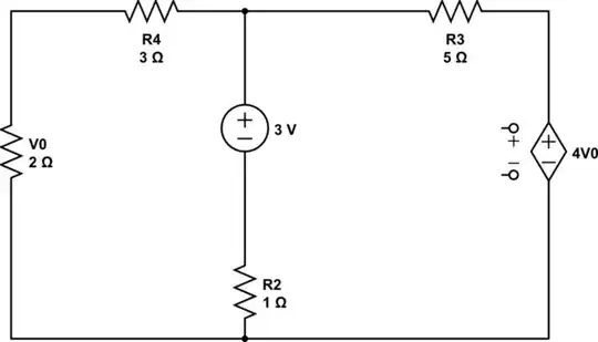

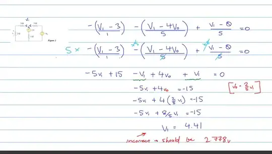

I'm currently doing a question and it appears to me that the direction of the current matters.
For both the batteries I've assigned a current direction that goes from the - to + terminal. So both batteries push the current into node V1 and the only exit is via (V1-0)/5.
However, I keep on getting it wrong. It appears to me that the current direction matters! But everyone online states that is not the case!
Can someone please explain what I'm doing wrong. I'm totally lost.

When we say that the choice of the current direction does not matter it doesn't mean that we apply equations without taking into consideration the chosen directions.
After chosing the current directions we will get values for these currents. If the value is negative it means that the current direction is opposite to the chosen one.
Your error is simply in the first equation. You must consider that the sum of currents entering the nodes is equal to the sum of currents leaving the node.
So in the first equation you just need to change the sign of (V1-0)/5 and you will get the right answer.

Could you please explain to me where I was not consistent?

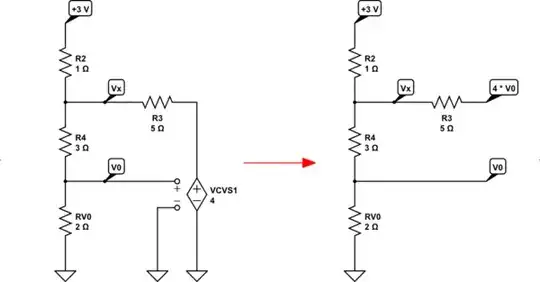

First off, already redraw the schematic using rules I'll add as an addendum below:
schematic
Note that you can choose to make any node you want to, ground. Here, looking at your schematic all I did was to swap the series positions of your \$3\:\text{V}\$ source and \$R_2\$, before making a decision about my choice for ground. The rest, above, just flowed out from that decision.
Note also that the voltage-dependent voltage-source is now more easily understood in terms of how it operates, too. And it was then easier to just get rid of it and replace the nodes, as shown on the right.
It really helps simplify the viewpoint if you'll just take a moment and learn how to redraw schematics for clarity. See the addendum below for some guidance.
Analysis
I prefer teaching my/Spice's method for nodal analysis, as it uses an important, highly simplifying viewpoint. You'll make fewer mistakes, early on, using it. (I'll add another note on that below, as well.)
In fact, your mistake makes my case! It's just far far too easy to get the signs wrong when applying the usual "nodal method" taught in most books. The method I apply is the one I took from reading Spice code, many years ago. It's what Spice does. And it's a very very good idea to follow it.
Watch, here below, and then read the addendum below on KCL:
$$\begin{align*} \frac{V_x}{R_2}+\frac{V_x}{R_3}+\frac{V_x}{R_4}&=\frac{3\:\text{V}}{R_2}+\frac{4\,V_0}{R_3}+\frac{V_0}{R_4}\\\\ \frac{V_0}{R_{V_0}}+\frac{V_0}{R_4}&=\frac{0\:\text{V}}{R_{V_0}}+\frac{V_x}{R_4} \end{align*}$$
(Spice uses this method as it processes each node in turn and does so, emitting the left sides of the equations as shown. The right side is then trivially also generated by the code. But the viewpoint, explained below in my addendum, is the product of my own thoughts.)
With regard to your own question about where you went wrong, I think you can now find that out:
$$\begin{align*} \frac{V_x-3\:\text{V}}{R_2}+\frac{V_x-4\,V_0}{R_3}+\frac{V_x-V_0}{R_4}&=0\:\text{V}\\\\ \frac{V_0-0\:\text{V}}{R_{V_0}}+\frac{V_0-V_x}{R_4}&=0\:\text{V} \end{align*}$$
All I did was to move fractions from the right side over to the left side. Now check the new equations and all the signs above against your own equations and I think you'll "see."
I promise you. You'll make fewer mistakes and have less confusion all around if you will do two things:
  1. redraw your schematics for better clarity; and,
  2. use the better nodal analysis viewpoint that I use.
Two equations, two unknowns. Solvable as: \$V_0=\frac{10}9\:\text{V}\$ and \$V_x=\frac{25}9\:\text{V}\$.

We have only one node thus, only one equation is needed. If I assume that the unknown voltage is the highest in the circuit.
This is what we get:
$$\frac{V_I}{5\Omega} + \frac{V_I - 4V_O}{5\Omega} + \frac{V_I -3V }{1\Omega} = 0$$
And due to the fact that we have a dependent current source, we need to write:
$$V_O = 4 *\frac{V_I}{5\Omega}*2\Omega = $$
After substitution the solition is
$$\frac{V_I}{5\Omega} + \frac{V_I - (\frac{8}{5}V_I)}{5\Omega} + \frac{V_I -3V }{1\Omega} = 0$$
$$V_I = \frac{25}{9}[V] \approx 2.77V$$

  • HI @G36, thanks for a response. But I wanted to know why I didn't get the correct answer. Your current directions at V1 are all exiting whereas my directions are different.
    I should be getting the same answer as you but I want to know why I'm not because multiple people have stated online that the current direction does not matter as long as it is consistent.
    – user36278 Apr 10 '21 at 16:14
    because you were not consistent with your current direction assumption – G36 Apr 10 '21 at 16:17
  • Could you please explain to me where I was not consistent? – user36278 Apr 10 '21 at 16:21
  • The first thing that you should do before starting the analysis is to decide for what current direction you will assign the "plus" sign and the "minus" sign.For example,I will give a minus sign if the current entering the node (coming into the node).And the plus sign if the current is leaving the node. In your example, 4Vo current is entering the node thus $-\frac{4V_O−V_I}{5Ω}$ do you see it? (4Vo - Vi)/5 means that the current will enter the node. Because the 4Vo is first in the equation implies that the current direction will be from 4Vo -->Vi (from higher potential to a lower potential). – G36 Apr 11 '21 at 08:49
  • The same is true for "3V current" $−\frac{3V−V_I}{1Ω}$ .And the last current is leaving the node $+\frac{V_I}{5Ω}$ So we have this $$-\frac{4V_O−V_I}{5Ω}−\frac{3V−V_I}{1Ω}+\frac{V_I}{5Ω}=0$$ do you get it? And to avoid making this kind of error in the future it is common to assume that "no matter what " we assume that all the currents will always flow out the node ( leaving the node). Thus, we can give the "unknown node" the higher potential in the circuit and the plus sign $$\frac{V_I}{5\Omega} + \frac{V_I - 4V_O}{5Ω} + \frac{V_I -3V }{1\Omega} = 0$$ This is why Vi is always first. – G36 Apr 11 '21 at 08:49
  • Do you see it now? https://electronics.stackexchange.com/questions/519072/how-to-find-the-nodal-voltage-when-there-is-a-voltage-source-across-two-nodes/519104#519104 – G36 Apr 11 '21 at 08:50
-1
The last +ve sign is the mistake, it should be -ve $$-\bigg(\frac{V_{1}-3}{1}\bigg)-\bigg(\frac{V_{1}-4V_{o}}{5}\bigg){\color{red}+}\bigg(\frac{V_{1}-0}{5}\bigg) = 0$$
Your assumption: -
$$i_{1} + i_{2} {\color{red}-} i_{3} = 0$$ $$-\bigg(\frac{V_{1}-3}{1}\bigg)-\bigg(\frac{V_{1}-4V_{o}}{5}\bigg){\color{red}-}\bigg(\frac{V_{1}-0}{5}\bigg) = 0$$ $$V_{1} = 2.77 V$$
