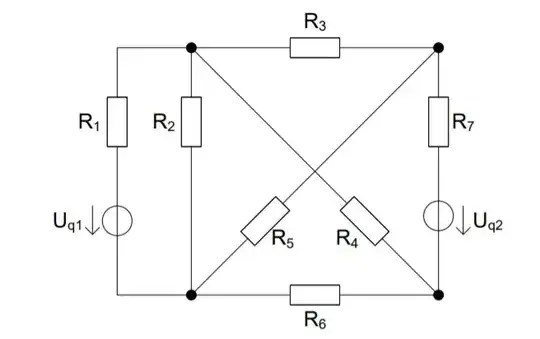

In my electrical engineering lecture we analyse such circuits with given Resistances \$R_i\$ and given \$U_{q1}\$ and \$U_{q2}\$ ( see example below ), and we try to find the current intensity \$I_{i}\$ at each point.
We use a long way to find them using matrices (Elimination using Gauss process, matrice transformation, Kirchhoff laws... (see 2nd picture)) + one error can cost errors everywhere.
  1. The problem is that I can't even check if my answers are correct when doing a exercise. Is there any tool on internet that calculates such things?
  2. Can you recommend any more secure and quicker way to analyse it?
Thank you in advance. Example of a circuitA part of the Procedure (sorry that it's in german)

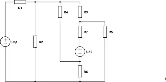

schematic
Figure 1. Circuit redrawn.
I don't know if this helps but it might simplify the analysis - or at least the rat's nest.

    There's a problem with the re-drawing above. Note that the OP's circuit includes a subcircuit that is tied into the node *between* $R_1$ and $R_2$. You have nothing there at all. So it cannot be a correct re-drawing. – jonk Feb 25 '21 at 18:06
  • I even had the reference drawing on a second monitor! How does it look now, @jonk. Thanks! – Transistor Feb 25 '21 at 18:11
  • Well, it at least passes that sniff test, now! Thanks. – jonk Feb 25 '21 at 18:12
  • Thanks, that's very helpful !! – Wassim Jaoui Feb 26 '21 at 10:18

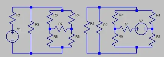

One could use superposition method to solve this one, where the two sources are considered acting alone. Currents of each circuit branch from the two circuits are summed.
It may be helpful to translate Thevenin (V1, R1) to Norton (I1, R1), and translate Thevenin (V2, R7) to Norton (I2, R7).
It may also be helpful to "un-twist" the network as shown below....one is always in danger of confusing current directions with superposition.
superposition

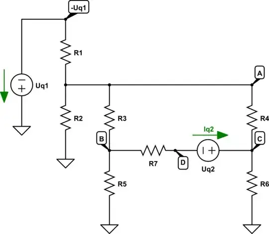

For analysis purposes, and assuming a certain meaning for your arrows with respect to the voltage sources, I'd redraw like this:
schematic
This can now be quickly turned into the following set of nodal equations:
$$\begin{align*} \begin{array}{c} {\text{Node } U_A:}\vphantom{\frac{U_A}{R_1}}\\\\ {\text{Node } U_B:}\vphantom{\frac{U_A}{R_1}}\\\\ {\text{Node } U_C:}\vphantom{\frac{U_A}{R_1}}\\\\ {\text{Node } U_D:}\vphantom{\frac{U_A}{R_1}}\\\\ {\text{Equiv:}}\vphantom{U_D + U_{q_2}} \end{array} && \overbrace{ \begin{array}{r} \frac{U_A}{R_1} + \frac{U_A}{R_2} + \frac{U_A}{R_3} + \frac{U_A}{R_4}\\\\ \frac{U_B}{R_3} + \frac{U_B}{R_5} + \frac{U_B}{R_7}\\\\ \frac{U_C}{R_4} + \frac{U_C}{R_6}\\\\ \frac{U_D}{R_7} + I_{q_2}\\\\ U_C\vphantom{U_D + U_{q_2}} \end{array} }^{\text{outflowing currents}} & \begin{array}{c} &\quad{=}\vphantom{\frac{U_A}{R_1}}\\\\ &\quad{=}\vphantom{\frac{U_A}{R_1}}\\\\ &\quad{=}\vphantom{\frac{U_A}{R_1}}\\\\ &\quad{=}\vphantom{\frac{U_A}{R_1}}\\\\ &\quad{=}\vphantom{U_D + U_{q_2}} \end{array} & \overbrace{ \begin{array}{l} \frac{-U_{q_1}}{R_1} + \frac{0\:\text{V}}{R_2} + \frac{U_B}{R_3} + \frac{U_C}{R_4}\\\\ \frac{U_A}{R_3} + \frac{0\:\text{V}}{R_5} + \frac{U_D}{R_7}\\\\ \frac{U_A}{R_4} + \frac{0\:\text{V}}{R_6} + I_{q_2}\\\\ \frac{U_B}{R_7}\\\\ U_D + U_{q_2} \end{array} }^{\text{inflowing currents}} \end{align*}$$
Using sympy:
var( 'ua ub uc ud iq2 r1 r2 r3 r4 r5 r6 r7 uq1 uq2' )
eq1 = Eq( ua/r1+ua/r2+ua/r3+ua/r4, -uq1/r1+0/r2+ub/r3+uc/r4 )
eq2 = Eq( ub/r4+ub/r5+ub/r7, ua/r3+0/r5+ud/r7 )
eq3 = Eq( uc/r4+uc/r6, ua/r4+0/r6+iq2 )
eq4 = Eq( ud/r7+iq2, ub/r7 )
eq5 = Eq( uc, ud+uq2 )
ans = solve( [eq1,eq2,eq3,eq4,eq5], [ua,ub,uc,ud,iq2] )
And from there you can generate any and all necessary values.
(If I elected the wrong polarity for your voltage sources, then adjust the above, appropriately.)
Now you have your answer regarding what tools you should acquire and learn to use.
