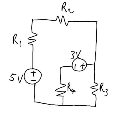

Assuming all the resistors have a resistance of 4 ohms, I’m having difficulty trying to figure out how to find the values for potential difference and current across each resistor. I tried to apply the law to 3 different loops in the circuit, giving me 4 simultaneous equations but there are no real roots. How do I go about tackling this problem?
Ffriends
  • 35
    You have only two unknown loop currents. So, only two equations are needed to solve this circuit. What are the equations you wrote down? Mark the currents in the diagram to avoid ambiguity when some one tries to answer the question. Find the currents, and then you can find the voltage across each resistor. – AJN Aug 27 '20 at 16:28
  • your statement should say something like potential difference across and current through each resistor – jsotola Aug 27 '20 at 17:11
  • @AJN If KCL is applied there is only one unknown node voltage. But yes, with KVL there are two unknown branch currents. – jonk Aug 27 '20 at 19:33

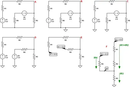

Redraw Your Schematic
Below, you'll see that I've gone through a series of thinking steps which respect the rules in the Appendix below. Reading from left-to-right across the schematics below, and then top-down, in that order you'll find the following:
  1. Step A to B: Add a ground, somewhere convenient. If a schematic doesn't have an indicated ground, you are allowed to place one on the schematic. You get to choose where. So if you are performing analysis, choose a convenient node and label it as zero (or ground.) If you don't mark such a node, then node voltages are impossible to assign, since you can add or subtract "a million" from all the nodes at once and change nothing at all about the schematic. So all you are doing is "tying down" the schematic, somewhere. And that is always legal to do, if the schematic doesn't already designate a place. Also, you are allowed to move the ground around to a different node, if it will help you in your analysis. So don't forget this power you have.
  2. Step B to C: Don't bus power around. In this case, since I just determined a node as ground, this means to remove the ground wires and just indicate them, separately, without the wire. It doesn't actually have to be a power rail in a realistic sense. It's enough that you've decided that it is a reference voltage. You don't bus "reference voltages" around, either. So the idea applies here.
  3. Step C to D: I'm allowed to change the order of series 2-terminal devices along a branch. In this case, it is very convenient to tether \$V_2\$ so that one end is "at ground." In the next step, you'll see why.
  4. Step D to E: Again, following don't bus power around, I've replaced the known voltages at certain nodes with nothing more than yet another "flag" that annotates that fact. This get's rid of the explicit voltage source symbol and that helps reduce clutter, which itself helps you better understand your analysis steps.
  5. Step E to F: Arrange conventional current to flow from top of sheet to bottom of sheet. This final step is just about re-orienting the schematic a bit. But it helps a lot, just the same.
schematic
Now that you are at F, you can see that there is really only one important node voltage that is unknown, \$V_X\$. This can easily be solved by using the following KCL:
$$\begin{align*} \begin{array}{c} {V_X}\vphantom{\frac{V_1}{R_1}} \end{array} && \overbrace{ \begin{array}{r} \frac{V_X}{R_1+R_2} + \frac{V_X}{R_3} + \frac{V_X}{R_4} \end{array} }^{\text{outflowing currents}} & \begin{array}{c} &\quad{=}\vphantom{\frac{V_1}{R_1}} \end{array} & \overbrace{ \begin{array}{l} \frac{V_1}{R_1+R_2} + \frac{0\:\text{V}}{R_3} + \frac{V_2}{R_4} \end{array} }^{\text{inflowing currents}} \end{align*}$$
If you solve that for \$V_X\$, which is just simple algebra to achieve, then you have enough information to answer other questions, as well. (See KCL Addendum below for a short explanation about setting up the above equation.)
You could also use KVL. Here, you have two simultaneous equations (knowing in advance that \$I_{R_3}=I_{R_1}+I_{R_4}\$):
$$\begin{align*} \begin{array}{c} {1:}\vphantom{V_1-I_{R_1}\cdot \left(R_1+R_2\right)}\\\\{2:}\vphantom{V_1-I_{R_1}\cdot \left(R_1+R_2\right)} \end{array} && \begin{array}{r} V_1-I_{R_1}\cdot \left(R_1+R_2\right) - \left(I_{R_1}+I_{R_4}\right)\cdot R_3 \\\\ V_2-I_{R_4}\cdot R_4 - \left(I_{R_1}+I_{R_4}\right)\cdot R_3 \end{array} & \begin{array}{c} &\quad{=}\vphantom{V_1-I_{R_1}\cdot \left(R_1+R_2\right)}\\\\&\quad{=}\vphantom{V_1-I_{R_1}\cdot \left(R_1+R_2\right)} \end{array} & \begin{array}{l} 0\:\text{V}\\\\ 0\:\text{V} \end{array} \end{align*}$$
And you need to solve these simultaneously for \$I_{R_1}\$ and \$I_{R_4}\$.
