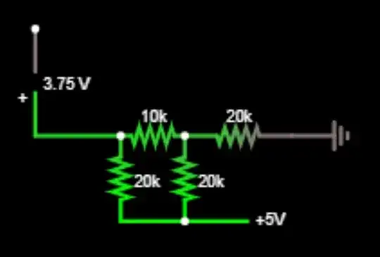

I have the following diagram I've set up in a simulator:
However I have no idea how they get 3.75V at that point (the upper left spot is a voltage reader) nor do I really even know how to apply Ohm's Law for series and parallel resistors because things are sort of joining at corners and I can't easily just pick two and say "these are in series" or "these are in parallel" because there's other "stuff" in between them. How do I wrap my head around this better?

Here's how to solve it step by step (without knowing anything about thevenin equivalents). You have to be able to understand how to do these kinds of reductions before you can get into thevenin analysis.
FIrst, ignore that 3.75V sense point for the moment. The 10k and 20k touching it are in SERIES. Look at the diagram until that's clear in your head. Effectively that's a 30k resistor.
Next, note that the other 20k which is connected in PARALLEL to that '30k' resistor. Again, look close until that sinks in. THis gives an equivalent resistance of (20k || 30k) = 12k.
Note it helps IMMENSELY to redraw the circuit every time you make one of these substitutions!!! (Actually at your level this is REQUIRED - Again I can do this in my head only because I've done this many many times before).
That 12k is in SERIES with the 20k connected to ground.
So overall that resistor network is 12k + 20k = 32k
Good so far???
Now apply the voltage divider equation to that 12k/20k ladder. You'll find the voltage to be (20k/(12k+20k)*5V) = 3.125V. So now we know there is 3.125V across that last 20k connected to ground. That means the rest of the mess has (5V-3.125V)=1.875V across it (i.e. if you place a voltmeter from 5V to that node, you'll get 1.875V)
This means there is 1.875V across the leftmost 10k/20k combo.
Again apply the voltage divider equation and you'll find the point of interest (between the 10 & 20k) is 0.625V
But that is relative to the node, NOT to ground. You have to now add the voltages to get to your solution (3.125 + 0.625) = 3.75

  • I will have to bust out some paper and pencil and try to walk through this, lol. I can get the total resistance = 32000 ohms part so far. – user260321 Aug 07 '20 at 02:55
  • Okay I got 3.125V at that first corner, so far so good – user260321 Aug 07 '20 at 02:58

  • Oooo I am having trouble now. I am 100% with you up to and including the 1.875V part. The drop over that square mess has to be 1.875V so that you get the 3.125V drop over the final 20k resistor. But knowing the drop of that whole mess, I am unsure what to do with that. Is there another way to proceed? I'm not clear on how you're applying the voltage divider at this step. – user260321 Aug 07 '20 at 03:10
  • Oh wait that 1.875V is not "shared" among all the resistors, I forgot it's just the potential difference from the same shared rail. So the voltage drop over that resistor connected between 5V and the 3.125V corner is in itself a 1.875V drop. That means the drop from the lower left corner to that 3.125V corner is also 1.875V. So that's 1.875V drop over the combination of the 20k and 10k resistors on the left. – user260321 Aug 07 '20 at 03:23
    So the lightbulb turned on :) Love it! – Kyle B Aug 07 '20 at 03:26
  • The voltage divider therefore gives 1.875 * 10/30 = .625V at the upper left corner, which assumes an input voltage of 1.875V and then ending at ground right after that, but in reality we're starting from 5V and ending at 3.125V. So I can just add 3.125V to the start and end of that section to bring it up to 5V-to-3.125V, and the corner jumps up by the same amount? – user260321 Aug 07 '20 at 03:27

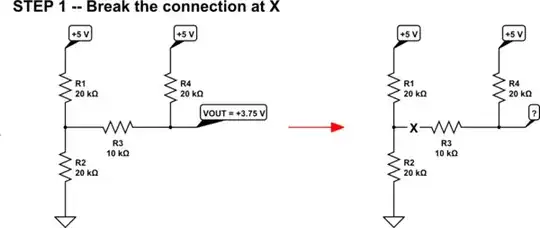

Even though you've accepted an answer, I'll explain the approach I gave in a comment so that you also follow what I wrote there.
I'm going to redraw your schematic. Often, this helps a great deal in understanding it. (See Appendix below.)
schematic
On the left, I've redrawn your schematic so that it is more readable. Please double-check it and make sure that you agree with me that it has the same behavior as your own version does.

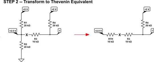

On the right side, I'm suggesting that you start the analysis by breaking the wire at the indicated location. Then we proceed to step 2:
schematic
simulate this circuit

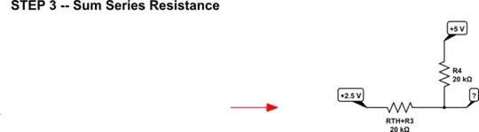

And then re-connect back up across the X and perform a simple series combination:
schematic
At this point all you have is very simple divider whose voltage is:
$$\frac{2.5\:\text{V}\cdot 20\:\text{k}\Omega + 5.0\:\text{V}\cdot 20\:\text{k}\Omega}{ 20\:\text{k}\Omega + 20\:\text{k}\Omega}=3.75\:\text{V}$$
