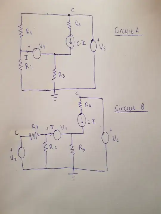

I am given the first circuit (A) and I have to find the voltage across R4. Since the potential at node C is independent (V2), I was thinking about a possible transformation to circuit B. However, I am not sure if it is valid or affects the currents within the circuit, since I remove the connection between R1 and R4. Are the two circuits equivalent regarding the voltage across R4?
Any help would be appreciated, thanks!

  • Yes, you can do that transformation. However, the magnitude of your added left-side V2 in the (B) circuit would *not* be the same as the magnitude of your right-side V2. – jonk Apr 29 '21 at 17:39
  • @jonk Thanks for the answer. Could you explain that a little bit more though? I am not sure I get it. – dimen Apr 29 '21 at 17:46
  • I added the necessary additional comments. I hadn't noticed $R_2$ in your (B) circuit, when writing out my earlier comment above. – jonk Apr 29 '21 at 18:00
Oh, heck. Much as I hate writing short answers, this one is okay I suppose. (But luckily I found a way to make it longer!! Hehe.)
Yes, you can do that transformation. However, the magnitude of your added left-side \$V_2\$ symbol in your \$B\$-circuit would not be the same as the magnitude of the right-side \$V_2\$.
Just to be clear, you can simply move your right-side \$V_2\$ symbol over to the far left of \$A\$-circuit, erasing the right-side version. Nothing has changed when you do that.
Now you can see that you have \$V_2\$ across a voltage divider pair of resistors, \$R_1\$ and \$R_2\$. Any voltage divider like this can be replaced with the Thevenin equivalents of the voltage source/divider pair: \$V_\text{TH}\left(V,R_x,R_y\right)=V\cdot\frac{R_y}{R_x+R_y}=\frac{V}{1+\frac{R_x}{R_y}}\$ and \$R_\text{TH}\left(R_x,R_y\right)=\frac{R_x\,R_y}{R_x+R_y}=\frac{R_x}{1+\frac{R_x}{R_y}}\$, where in your case \$R_x=R_1\$ and \$R_y=R_2\$ and \$V=V_2\$.
When you make the replacement, though, do NOT forget that you still have \$V_2\$. It doesn't go away. Your \$B\$-circuit is correct in that sense. You kept \$V_2\$. However, your left-side \$V_2\$ is really now \$V_\text{TH}\$.
There is another mistake in your \$B\$-circuit. You retained BOTH \$R_1\$ and \$R_2\$, it appears. When you make the transformation, there is only \$R_\text{TH}\$ in series with \$V_\text{TH}\$ to the same node. There is no longer any \$R_1\$ and \$R_2\$.
So even if you take your \$B\$-circuit and replace the left-side \$V_2\$ with the newly computed \$V_\text{TH}\$ and replace \$R_1\$ with the newly computed \$R_\text{TH}\$ -- both correct things to do -- you are still left with that wayward \$R_2\$ there, which is definitely wrong. You need to get rid of \$R_2\$, entirely, now.
Does this help sufficiently well?
Or do you need to see a progression of diagrams?

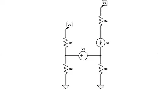

Speaking of which, I think you could do a LOT better if you'd follow an addendum I'm adding on re-drawing schematics. You should get into a regular practice of re-drawing every schematic that faces you, too. It's just the right thing to do -- every time.
I'll re-draw yours here below. But go read the addendum to see how/why I did it. Then tell me... does it read better? I think so:
schematic

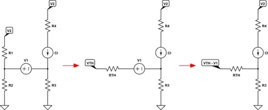

Now I can easily see a few things to transform:
schematic
simulate this circuit
And since a current source has infinite impedance it follows that \$R_4\$ is completely irrelevant. It's nothing when compared to \$\infty\:\Omega\$. All its presence does is to change the voltage across \$C_I\$. But it does not affect the circuit. So it now becomes:
schematic
Note that I didn't even keep the voltage node at the top of the current source. That's because it doesn't matter, either. All it does is to also change the voltage across \$C_I\$. And that makes absolutely no difference whatsoever to analyzing the circuit for its most important unknowns.
You now have the simplified diagram, which should be readily analyzed.
Well.... You could simplify it still further. Do you see yet another divider pair there? Yes, you could make it still simpler!! But maybe then it would be too simple. At least with the above, you can work out the voltage across \$R_3\$, from which all the rest becomes easy when going back to the earlier simplified diagram!

    Thanks for the diagrams, they really helped! So, if I have understood correctly, if we have a node at a given potential Va which connects two circuit elements (just like in the initial circuit) we can "separate" it to two nodes and model them as voltage sources Va with reference to the ground? Sorry if my description sounds a bit abstract, I'm basically trying to sum up the methodology you followed. – dimen Apr 29 '21 at 18:37
    @dimen First off, you get to call any one node you like "ground." For analysis purposes, that's your own call. If someone gives you a schematic that has a ground, you are free to remove that and put it somewhere else that is more convenient. So keep that in mind. You have the power! Now to your question. Since there was a voltage and a resistor divider *with one end at ground* then yes you can replace that divider with a thevenin voltage also referenced to ground and a series resistor. – jonk Apr 29 '21 at 18:44
  • @dimen However, if you see a voltage dividing resistor pair like that one and *neither* end is tied to ground, but instead to two different voltage sources (each of which are referenced to ground) then you must perform a different computation to work out the ground-referenced voltage you can use for it. There, the ground referenced voltage would be $\frac{V_1\cdot R_2+V_2\cdot R_1}{R_1+R_2}$, where $R_2$ is the resistor connected to $V_2$ and $R_1$ is the resistor connected to $V_1$. The thevenin resistance, though, would be the same as before. – jonk Apr 29 '21 at 18:45
    @dimen Note that if you replace one of the voltages with 0 V, you get the original, simpler equation. – jonk Apr 29 '21 at 18:48
