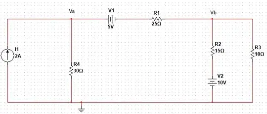

How would you solve this circuit with nodal analysis? I know it's the difficult route but it's a requirement. I understand that I need to create a super node that combines nodes a and b, and I have shown my equation below. However I am stuck with coming up with the second equation needed to solve the circuit.
My supernode equation:
$$\frac{V_a}{30} + \frac{V_B - 10}{15} + \frac{V_B}{10} = 2$$
For my second equation I tried a KVL in the middle loop but I get all the terms canceling out:
$$(0 - V_a) + 5 + (V_a - 5 - V_B) + (V_B - 10) + 10 = 0$$
where \$(0-V_a)\$ is the voltage across \$R_4\$, \$(V_a-5-V_B)\$ is the voltage across \$R_1\$ and \$(V_B-10)\$ is the voltage across \$R_2\$.

    In this case, you don't need to use a supernode. For example o for node Va we can write $$\frac{V_A}{30\Omega} + \frac{(V_A - 5V) - V_B}{25\Omega} = 2A$$ Do you see it? – G36 Dec 05 '21 at 13:25
  • @G36 Hi, it turns out your KCL and my super node eqn provide the correct answers for Va and Vb. The textbook states that the usually a supernode and KVL combination is whats required to solve most problems but it seems this is a special case. Thanks for helping to shed new light on this problem! – programmer25 Dec 05 '21 at 13:56

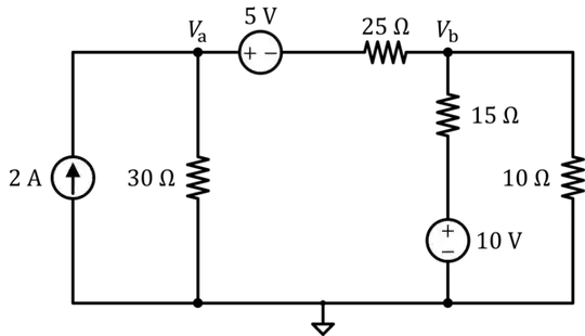

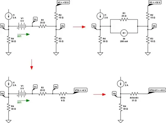

Here's my re-drawing:
schematic
The upper right side uses a Norton conversion of \$V_1\$ and \$R_1\$ on the upper left side. But they are equivalent.
As shown, you could continue from the upper left side by converting \$V_2\$, \$R_2\$, and \$R_3\$ into yet another Thevenin equivalent. And you could even do that one more time (not shown.)
In other words, this circuit can be reduced to almost an almost trivial approach for solving \$V_{_\text{A}}\$.

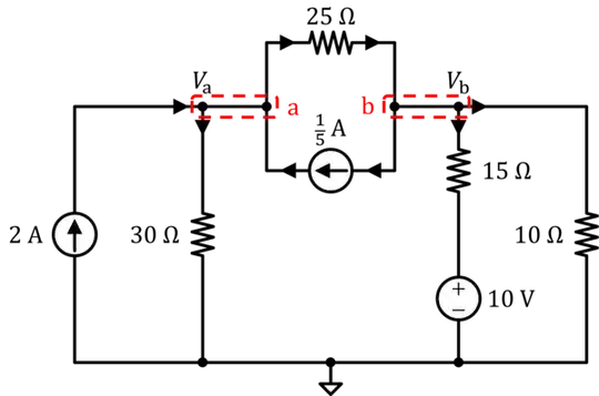

Just as a double-check, we can use the lower right hand corner schematic and convert the remaining resistor divider into its Thevenin equivalent of \$V_{_\text{TH}}=\frac{270}{61}\:\text{V}\approx 4.426\:\text{V}\$ and \$R_{_\text{TH}}=\frac{930}{61}\:\Omega\approx 15.246\:\Omega\$. Pushing \$2\:\text{A}\$ through that Thevenin impedance means adding \$\approx 30.492\:\text{V}\$ to \$4.426\:\text{V}\$, or \$V_{_\text{A}}\approx 34.918\:\text{V}\$. And that matches the above computation for it, quite well.
Note that no "super node" was introduced here. The only addition is the current in \$V_1\$. (You can choose the direction, as you wish.)

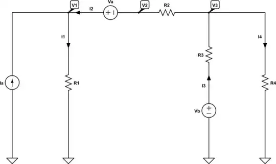

Well, we are trying to analyze the following circuit:
schematic
When we use and apply KCL, we can write the following set of equations:
$$ \begin{cases} \text{I}_1=\text{I}_\text{a}+\text{I}_2\\ \\ \text{I}_3=\text{I}_2+\text{I}_4 \end{cases}\tag1 $$
When we use and apply Ohm's law, we can write the following set of equations:
$$ \begin{cases} \text{I}_1=\frac{\text{V}_1}{\text{R}_1}\\ \\ \text{I}_2=\frac{\text{V}_3-\text{V}_2}{\text{R}_2}\\ \\ \text{I}_3=\frac{\text{V}_\text{b}-\text{V}_3}{\text{R}_3}\\ \\ \text{I}_4=\frac{\text{V}_3}{\text{R}_4} \end{cases}\tag2 $$
And we also know that \$\text{V}_1-\text{V}_2=\text{V}_\text{a}\$.
We can use \$(2)\$ and \$\text{V}_1-\text{V}_2=\text{V}_\text{a}\$ in order to rewrite \$(1)\$:
$$ \begin{cases} \frac{\text{V}_1}{\text{R}_1}=\text{I}_\text{a}+\frac{\text{V}_3-\text{V}_2}{\text{R}_2}\\ \\ \frac{\text{V}_\text{b}-\text{V}_3}{\text{R}_3}=\frac{\text{V}_3-\text{V}_2}{\text{R}_2}+\frac{\text{V}_3}{\text{R}_4}\\ \\ \text{V}_1-\text{V}_2=\text{V}_\text{a} \end{cases}\tag3 $$

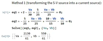

Method 1: Applying source transformation
If you've already been taught about source transformations, and are allowed to use them in your circuit, then we can transform the 5-V source into a (5 V)/(25 Ω) = 1/5-A current source, with the reference direction pointing to the left. The resulting circuit diagram is the following. The arrowheads indicate the reference direction I've arbitrarily chosen for the currents to be used in KCL.
Figure 2
Figure 2. Circuit diagram for the first method. Image source: own.
Applying KCL at node a:
\$ + 2 \text{ A} - \dfrac{V_\text{a}}{30 \text{ } \Omega} + \dfrac{1}{5} \text{ A} - \dfrac{V_\text{a} - V_\text{b}}{25 \text{ } \Omega} = 0 \text{ A} \tag 1 \$
Applying KCL at node b:
\$ - \dfrac{1}{5} \text{ A} + \dfrac{V_\text{a} - V_\text{b}}{25 \text{ } \Omega} + \dfrac{10 \text{ V} - V_\text{b}}{15 \text{ } \Omega} - \dfrac{V_\text{b}}{10 \text{ } \Omega} = 0 \text{ A} \tag 2\$
Now you have two simultaneous linear algebraic equations (eqs. (1) and (2)) with two unknowns (\$V_\text{a}\$ and \$V_\text{b}\$), which you can thus solve. The result is shown next.

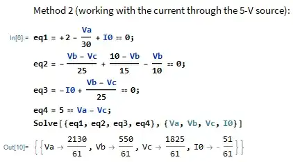

Method 2: Working with the current through the 5-V source as an unknown
In this method, we simply work with the current through the 5-V source as an additional unknown. Let's call it the current \$I_0\$, with the reference direction pointing to the left. Also, instead of just considering junctions (i.e. nodes with three or more interconnections), we'll additionally consider the node between the 5-V source and the 25-Ω resistor; let's call it node c. This is shown in the following circuit diagram.
Figure 4
Figure 4. Circuit diagram for the second method. Image source: own.
\$ + 2 \text{ A} - \dfrac{V_\text{a}}{30 \text{ } \Omega} + I_0 = 0 \text{ A} \tag 3 \$
\$ -\dfrac{V_\text{b} - V_\text{c}}{25 \text{ } \Omega} + \dfrac{10 \text{ V} - V_\text{b}}{15 \text{ } \Omega} - \dfrac{V_\text{b}}{10 \text{ } \Omega} = 0 \text{ A} \tag 4\$
Applying KCL at node c:
\$ - I_0 + \dfrac{V_\text{b} - V_\text{c}}{25 \text{ } \Omega} = 0 \text{ A} \tag 5 \$
Since there's now another unknown, we need a new equation. That's the constraint or auxiliary equation, which we get by expressing the voltage of the 5-V source in terms of the nodal voltages of the nodes adjacent to such source. Applying KVL around the loop aca (or by simply looking at the circuit diagram, and the polarity of the 5-V source and the location of nodes a and c), we get the constraint/auxiliary equation to be:
\$ 5 \text{ V} = V_\text{a} - V_\text{c} \tag 6 \$
Now you have four equations (eqs. (3), (4), (5) and (6)) with four unknowns (\$V_\text{a}\$, \$V_\text{b}\$, \$V_\text{c}\$ and \$I_0\$). The result is shown next; notice it's the same as in the previous method.
Figure 5
Figure 5. Solution for the second method. Image source: own.

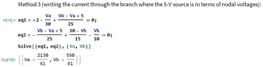

Method 3: Writing the current through the branch where the 5-V source is, in terms of nodal voltages
In case you didn't know, it's possible to write or express the current through a V-R branch (that is, a branch consisting of a voltage source in series with a resistor) in terms of the nodal voltages of the two terminals of such branch. The formula is easy to prove, though I won't do it in this answer. It's as follows, provided the reference direction of such current is such that it exits the voltage source through the positive reference terminal of the source:
\$ I = \dfrac{V_\text{leaving} - V_\text{entering} + V_\text{source}}{R} \tag 7 \$
Let's use this fact to formulate the equations. The circuit diagram is the following.
Figure 6
Figure 6. Circuit diagram for the third method. Image source: own.
\$ + 2 \text{ A} - \dfrac{V_\text{a}}{30 \text{ } \Omega} + \dfrac{V_\text{b} - V_\text{a} + 5 \text{ V}}{25 \text{ } \Omega} = 0 \text{ A} \tag 8 \$
\$ - \dfrac{V_\text{b} - V_\text{a} + 5 \text{ V}}{25 \text{ } \Omega} + \dfrac{10 \text{ V} - V_\text{b}}{15 \text{ } \Omega} - \dfrac{V_\text{b}}{10 \text{ } \Omega} = 0 \text{ A} \tag 9\$
Now you have two equations (eqs. (8) and (9)) with two unknowns (\$V_\text{a}\$ and \$V_\text{b}\$). The result is shown next; notice it's the same as in the previous methods.

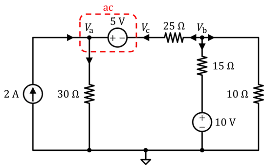

Method 4: Forming a supernode with nodes a and c
As you know, we form a supernode, which is really a closed boundary that includes the adjacent nodes of the voltage source between the two non-reference nodes. In your circuits, they're nodes a and c, since the 5-V source is connected between those nodes. The circuit diagram is the following.
Figure 8
Figure 8. Circuit diagram for the fourth method. Image source: own.
Applying KCL at supernode a-c:
\$ \underbrace{+ 2 \text{ A} - \dfrac{V_\text{a}}{30 \text{ } \Omega}}_{\text{node $a$}} \underbrace{+ \dfrac{V_\text{b} - V_\text{c}}{25 \text{ } \Omega}}_{\text{node $c$}} = 0 \text{ A} \tag {10} \$
\$ -\dfrac{V_\text{b} - V_\text{c}}{25 \text{ } \Omega} + \dfrac{10 \text{ V} - V_\text{b}}{15 \text{ } \Omega} - \dfrac{V_\text{b}}{10 \text{ } \Omega} = 0 \text{ A} \tag {11}\$
We have two equations but three unknowns; we need an auxiliary/constraint equation, which is the one indicating the voltage of the 5-V source in terms of nodal voltages:
\$ 5 \text{ V} = V_\text{a} - V_\text{c} \tag {12} \$
Now you have three equations (eqs. (10), (11) and (12)) with three unknowns (\$V_\text{a}\$, \$V_\text{b}\$ and \$V_\text{c}\$). The result is shown next; notice it's the same as in the previous methods.
Figure 9
Figure 9. Solution for the fourth method. Image source: own.
As you can see, the difference between your and my application of the supernode is that you formed the supernode with nodes a and b (and c), while I formed it only with nodes a and c. In your case, you got correct the first equation, but failed to formulate the constraint/auxiliary equations.
