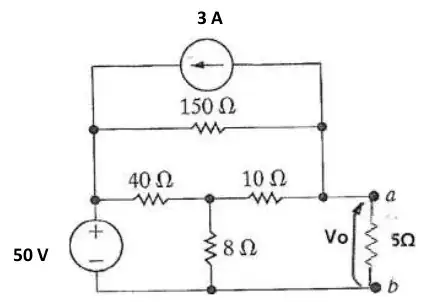

I tried to do an exercise from my textbook where I have to apply the Thevenin theorem, but can't solve it. I got stuck at one point.
Given the circuit in the picture find the V0, Vth and Rth.
Circuit

  • Is the 5 Ohm resistor at points a and b to be removed for analysis purposes? – jonk Sep 19 '21 at 18:59
  • yes, it will be an open circuit. – Andrew Rusell Sep 19 '21 at 21:00
  • Is the V0 to be determined with the 5 Ohm resistor attached? (Because, if not, then V0 = VTH and that part is then easy.) – jonk Sep 19 '21 at 21:04
  • Yes, V0 will consider the 5ohm resistor. I can't understand how to get the value of VTH actually – Andrew Rusell Sep 19 '21 at 21:29

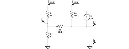

Redrawn
Those things said, I see the following schematic:
schematic
Note that I've chosen a ground (to be the same as node b), for my convenience. Note also that I've removed the voltage supply and simply used annotations to track where it is applied. These things often make the circuit simpler to consider, I think.

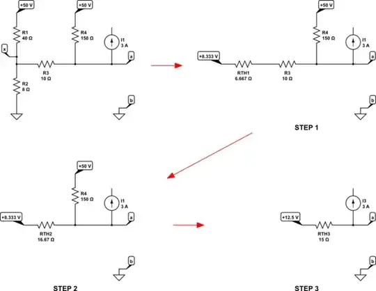

Stepwise Simplification
Now, you can solve this many different ways. You tried "mesh" or using KVL. But there are only two unknown node (a and x) voltages. So you could also solve this with KCL.
But let's avoid both of them and use step-wise Thevenin simplification of resistor dividers to get to the end-point. I'll come back and hit this using both KVL and KCL.
So, note the following schematic simplification steps:
schematic
simulate this circuit
I won't work all the individual equations for you. I think you can do that on your own. But above you can see that the circuit simplifies down to a point where all you need to do is calculate:
$$V_{_\text{TH}}=+12.5\:\text{V}-15\:\Omega\cdot 3\:\text{A}=-32.5\:\text{V}$$
No KCL or KVL (not directly, anyway.) Just step-wise simplification.
(Note also that we could have also chosen to start with a Norton to Thevenin conversion of \$I_1\$ and \$R_4\$.)

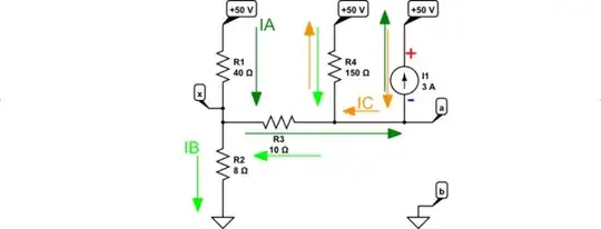

KVL
For this, my simplified circuit is a slight pain. (Proof that one schematic form doesn't serve all methods equally well.) So here is the schematic, with a few additions:
schematic
Now you can see why I mostly hate mesh analysis. Once you do this a few hundred times in different ways, you will also grow to hate mesh analysis -- using it only rarely when it is obviously easier.
I'm showing three current loops, above. But also there is another variable to add: the voltage across the current source. Note that I'm calling this \$V_{I_1}\$ and the sign choice I made is also shown on the schematic, above.
$$\begin{align*} V_1 - R_1\cdot I_{_\text{A}} - R_3\cdot\left(I_{_\text{A}}-I_{_\text{B}}\right) + V_{I_1}&=V_1 \\\\ V_1 - R_4\cdot\left(I_{_\text{B}}-I_{_\text{C}}\right)- R_3\cdot\left(I_{_\text{B}}-I_{_\text{A}}\right)-R_2\cdot I_{_\text{B}}&=0\:\text{V} \\\\ V_1 - V_{I_1} - R_4\cdot\left(I_{_\text{C}}-I_{_\text{B}}\right)&=V_1 \\\\ I_{_\text{A}}-I_{_\text{C}} &= I_1 \end{align*}$$

And now you can get:
$$V_{_\text{TH}}=V_1 - V_{I_1}=50\:\text{V} -\frac{165}2\:\text{V}=-32.5\:\text{V}$$
Same answer.
I'll let you work out where you went wrong with the KVL approach. (They may have been trying to teach you "supernodes," which I don't care about nor use. If you need to learn to use them, I'll leave it to you.)
