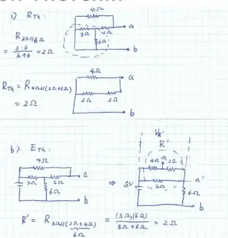

In a lecture for an Electrical Engineering course I was taking, the professor did an example on solving a Thevenin circuit.
When he solves the circuit for Thevenin resistance he adds two resistors in parallel between the open circuit "a" port, however when solving to make an equivalent resistor to find the voltage he goes and adds two resistors in series between the same "a" open circuit. I am confused as too how this is allowed.
I would think that for both cases either it could only be added in parallel or series however this seems to not be the case. The only thing that changes is that now there is a voltage source and I am confused on how that has an effect on the calculation of resistance.
Picture for reference of solution:

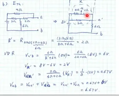

Edit: Added full solution of the problem using Thevenin:

  • the circuit does not change in the second solution ... the resistors can be oriented any way you like ... note: between the open circuit "a" ... you cannot have anything between only one point ... when something is between, it is always between two or more points – jsotola Oct 01 '20 at 02:59

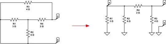

When reading what follows, keep in mind that you are always allowed to select one of the wires (nodes) and designate it as \$0\:\text{V}\$ (or ground.) That is your prerogative. In my work below, I've chosen to make b the same as ground.
Just redraw the first circuit:
schematic
Now it is completely obvious how it is that \$R_1\$ and \$R_2\$ can be taken in-parallel and Thevenized that way into \$\frac{R_1\: R_2}{R_1+R_2}=2\:\Omega\$. That value is then in series with \$R_4\$, so just add the two values together. And that result is in-parallel with \$R_3\$. So it's pretty easy.
One of the things that you need to learn early is to realize that our brains are often easily misled. Just get into the practice of patiently sitting down, getting out paper and pencil, and re-drawing what you see in a completely different way. Do this with intention. Make it radically different. But make sure that all the connections (nodes) are correct, of course.
You'll begin to see in a new way, soon enough.

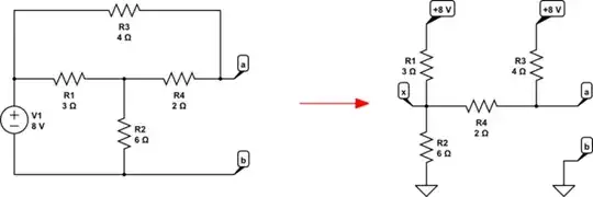

Again, re-draw:
schematic
simulate this circuit
You can now Thevenize \$R_1\$ and \$R_2\$ with \$V_1\$'s voltage. That resulting Thevenin resistance will be in series with \$R_4\$, so just add them. Now you have your \$V_1\$ source at one end of a voltage divider and your Thevenin source, \$V_x\$, at the other end. That means the final resulting Thevenin resistance will be those two values, the earlier result and \$R_3\$, taken in-parallel again. You can also easily compute the new Thevenin voltage from the divider pair, as well.
