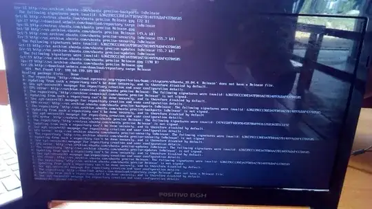

I tried to remove python3.6 by using this command sudo --purge configure python3.6 then after processing this code it seems all configurations were deleted. then after rebooting system my PC can not back to the desktop it returns to tty1 and can not install any dependencies and cannot update the system. When I try sudo apt-get update

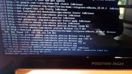

this is about update system screenshot is here

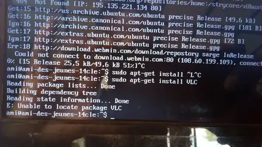

When I tried to install sudo apt-get install VLC I got this.
install any application screenshot is here

I would venture to say that you are in need of a complete reinstall. Deleting all configuration files will be extremely hard to fix. Also NEVER delete Python. If you need other versions, learn to use virtual Python environments.
